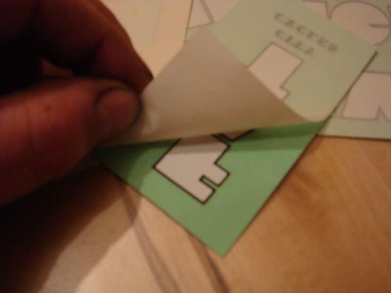

thanks rody this sounds complicated but im sure im all over it! one thing my decals the decal is face down onto the card peice the transfer paper (or not in this case) peels off to reval the underside of the decal this seems to be the reverse of what you said? do i leav the decal on the card and use the card as the transfer paper? as if i left it on the thinner opaque paper the deal is the wrong way round hope this makes sense?

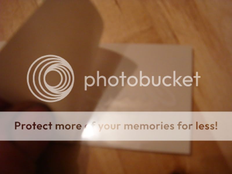

heres a few pics of the decals, like i said the transfers are face down on the card which is not adhesive which is going to make it damn hard to position them!
Thanks for the pic...you should be ok.
There is actually a super thin transfer layer between that card and the decal. Try to gently get in between the two with an exacto knife and it will lift free.
I've got an old set of Wickeds that are set up the same way.
The part you are shown lifting away in the pics is the part you MUST keep dirt free, so if you have not already, put it back!
So, when you are ready, peel off the back layer, peel from the card stock, then apply, debase and remove the transfer sheet.
