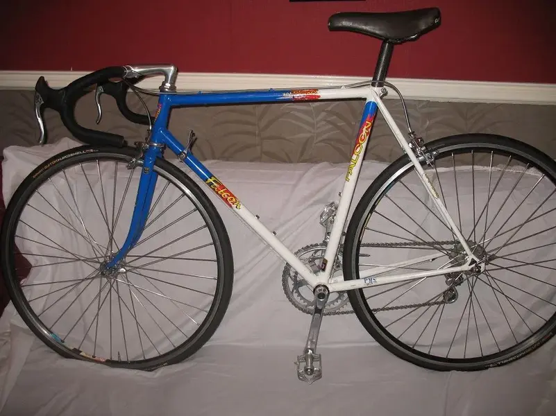

FALCON - PMS 753

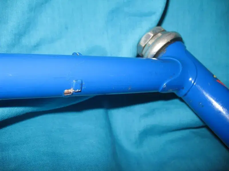

Stripped and ready to clean up. Such a shame the race number hanger lug has broken off :-(

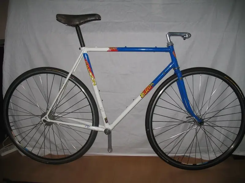

A couple more photos,Frame cleaned up, looks much better. I have refurbished the wheels it came with, they are straight as can be, Rigida Ultimate power with Miche Team Hubs. Dont know much about these wheels but they run great, I wouldn`t have thought they were pro quality so a later addition, new continental gatorskin tyres , not my choice but they came on another bike I bought recently and have never seen tarmac. I regreased and adjusted the BB and headset. Bought a new ITM stem 110mm , a seller had a batch of them cheap on ebay for about £15 a piece. All the Dura Ace kit is being polished up, its slow progress as I dont have much free time at the moment. Need to find a 26.8 Dura Ace seat post, the carbon effect thing on there at the moment is a Tioga but it will do for now.

originalshinkicker":3lmpxn28 said:
I wouldn't have expected a late 80s 753 frame to use a 26.8mm seat pin
I have read lots of varying opinions about 753 seat tube size, some good discussions regarding this also on this forum. I don`t have the expertise to say if it is unusual but there do seem to be examples of early 26.8 seat post 753`s discussed . Mine definately is 26.8 , maybe there was some technical reason for Falcon to use this, maybe it varied with frame size or they simply got one batch of tubing that size as they seem only to have built with 753 for team use ( unless anyone knows different ).
If it is Metric tubed 753 then 26.8 is an option, as the heavier 0.7/0.4 gauge metric tube would use that size. The lighter 0.7/0.3 metric 753 used 27.0
If it is Imperial tubed 753 then 26.8 would mean a very thick seat tube. Imperial 753 would typically be 27.2 for a 0.7/0.5 gauge seat tube or 27.4 for a 0.7/0.4 gauge.
Doh... You`re right , it IS 27.0 seat tube. Just bought a nice 26.8 seat post without checking properly and it`s too small . oh why didnt I read your message properly...Thanks for the expert info.
