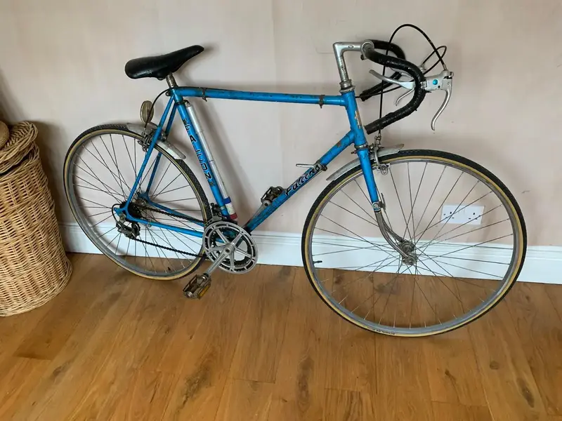

Hi all. Reading the various threads it appears to be a bit of a lottery to identify older Falcon bikes. Looking at all the old brochures I’m not clear what this one is. Just been given it by my father in law and I’m looking to renovate it (just for fun). So been in the family since the early eighties and no reason to think it’s been modified in that time.
Originally thought it was an Olympic but it has 12 speed, Shimano RS gears, and shimano brakes and brake levers. Sadly no evidence of any decals on the top tube. Front badge has the Olympic rings and designer signature. Is it perhaps a champion du monde in blue?
Any pointers gratefully received.
Around the late 70s/early 80s Falcon wasn't in a great place and produced multiple very similar models based on the same imported frame which didn't appear in catalogues. The frame is the same as the gold version used on the model 62 Panther and many others but from the kit on it (the 12 speed) I'd risk a guess that it is based on a champion du monde..
in case you are curious as to a specific date there are several fittings on the cycle which should exhibit such marking:
portion of stem down inside steerer
right end of bar
rear mech
backside of crank arms
for markings which are coded there is a decryption guide here -
http://www.vintage-trek.com/component_dates.htm
small safety tip -
stem is dangerously high
there should be a good 6-7cm of stem down inside steerer for safety
misadventures at this location can be regrettable...
dosh -
cycle not valuable when new and has not gained value in the interim so if you wish to retain for either utility or sentiment that is fine
worth it to do a disassembly, lavandation and lubrication, replacing any worn out bits as you go
not worth it to invest in upgrades
thanks for sharing with the forum and best wishes with it ;)

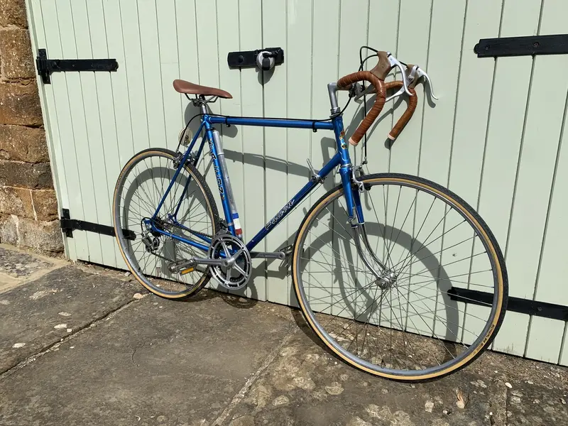

The frame and forks have cleaned up very well, overall it looks great, the only thing is that the handlebars are tilted backwards way past where they should be. It's a common thing if you're not used to drop bars, the brake levers can feel too low down, but the hoods of the levers should be much more parallel to the ground.
If you’re planning on riding it, you won’t get proper purchase on the brake levers with it like that. The solution if they still feel too low down is a taller stem.
Congratulations on a fine job! 🥳
Wonderful to see it completed.
Puzzled by registration of crank arm to spider between the "as found" and completed states. Makes me wonder if swaging worked loose...
