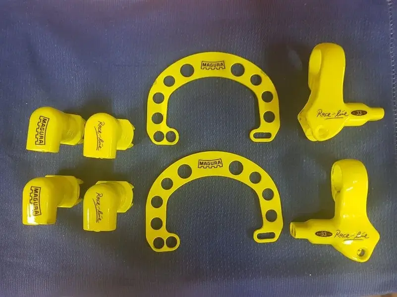

Just wondered if anyone had managed to restore the colour to faded hs33 brakes in flouro yellow?
