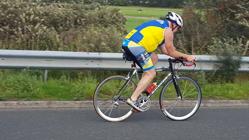

Circa 1995/6 Vento race wheels (Picture taken this Sep, still 20Kg over the weight limit, but not 40 over!...)
