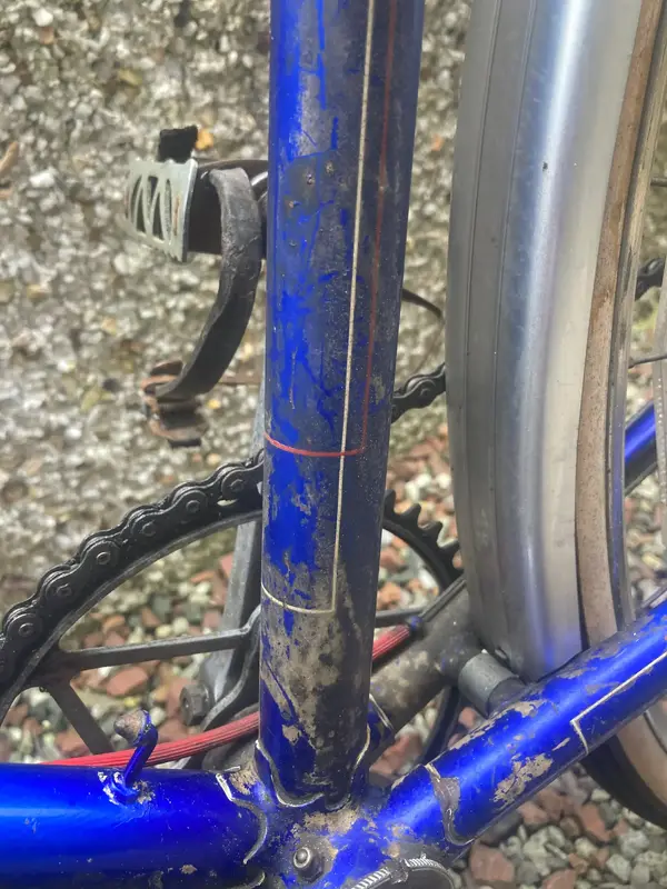

I managed to spend a half an hour or so with it earlier, mostly trying to remove some of the strange stuff that’s covering the frame. It’s almost like dried out furniture polish - but much thicker in some places than others.
Not waxy at all now, some bits come away with light finger nail pressure. I’m attempting to find the least potent cleaner possible to remove it. Whatever it is smears off with Lidl’s current bike cleaner spray, but there are ancient decals there too that I’m being careful with.

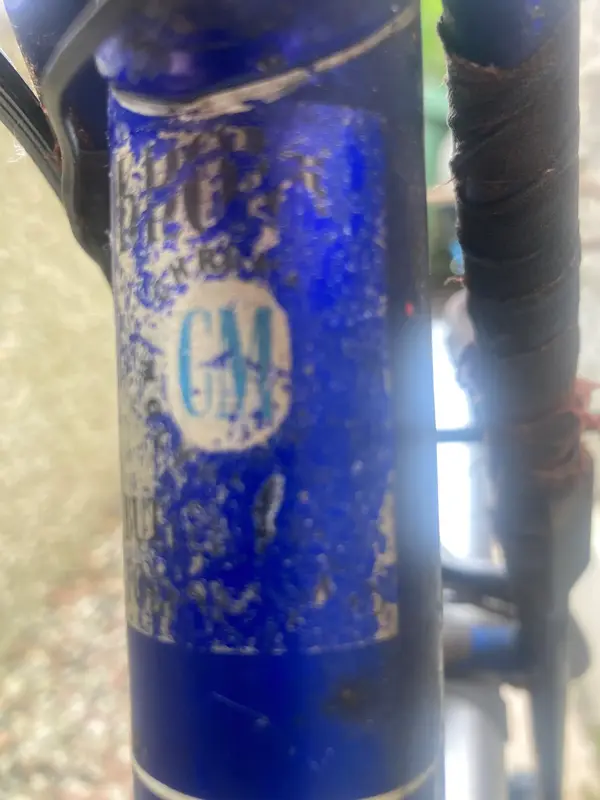

Talking of decals, I had hoped the tubing spec label might have come up a bit better, but it looks like a lot of it is long gone. All I can read so far is “chrome moly…” around a two letter logo - the first being a “C”or “G” - and then “BUTTED” I think and below that FO…. There’s a pic in the second post.

Someone might have gone over the frame with Linseed oil or similar to protect the frame.
I would expect the frame to be Reynolds 531. What diameter is the seatpost?

It’s covered in a very uneven coat of something! Uneven enough that I assumed at first that it had been the victim of several garage spills over the years. You can see the off-white/ beige residue caught around the lugs in the head badge shot. Actually, I’ve just had another look and that’s not as clear as it could be - the white lining may confuse things. It wouldn’t surprise me if someone had oiled up the frame, the bike has certainly been attended to by the look of the overall condition it’s in. Hard to believe it’s 76+yrs old!
thank you for information on tubing transfer
t'is one doona recall seeing previously
was wondering if it could be something from A&P...
whenst ye take up disassembly ye may find marking on steerer

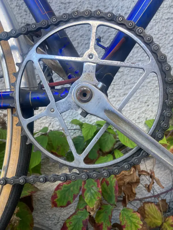

curious as to maker of the cycle's y-pattern chainset
Spot on with the pedals, Sir!

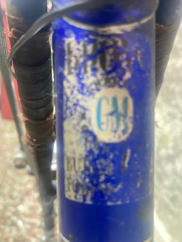

I’ve attached a couple more shots of the Chro-Mo badge after another wipe down. It looks to say “KROM..” along the top. The roundel says “CM” I’m pretty sure.
It’s certainly not the age appropriate Reynolds badge from what I can make out.
No sign of any markings on the chainring or cranks so far.

Postponed some ‘working from home’ to have another coffee and quick look at the bike…

That's an Accles & Pollock 'Kromo' decal:

So with some eagle-eyed spotting on here and a bit of digging around, it seems that the spec as it stands is:-

I’m quite intrigued by the tubing. It’ll be interesting to find out out the spec - it’s not the plain tubing as per the badge posted earlier.
I think you’re right. When I got lost down the A&P rabbithole earlier it seemed that they did several versions. Other than their claim that a Kromo frame saved 22 1/2 ounces in weight over a hi-ten version I didn’t find any definitive listing of the tubes they supplied. Living near to the old Flying Scot works, it was nice to see that Rattrays was a customer!
A couple of pics from earlier to show the dried on “stuff” that, to give it its dues, seems to have protected the frame pretty well. Not sure if it’s been done before laying the bike up, or whether it’s simply accidental spills!
Some is lighter in colour and very dry, other bits are darker and oilier - there doesn’t seem to be any rhyme nor reason to these areas…

I also came across an interesting blog on vintage lightweights where I noticed the attached pic. Could it be the chain set is Nicklin Triangular?
