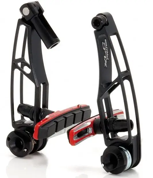

For a budget version, the XLC looks a lot better than KCNC etc on the fittings, but that spindly girder arrangement never going to be as stiff as the thin walled box section Extralite since again, the side bracing is all wrong:
I know which brakes I would trust my life on. Well worth the extra cost.
