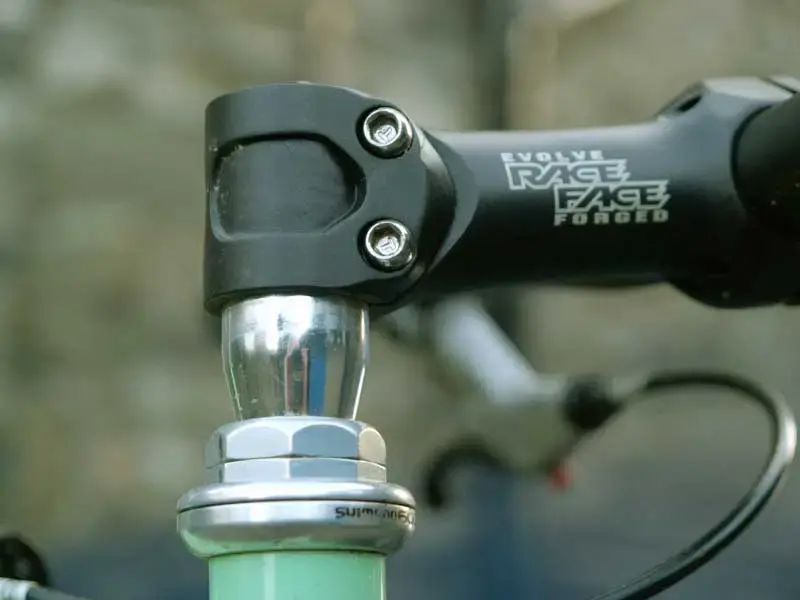

I've ben using one for the last four years on my'88 Explosif.
I can't remember where I got it from but it does the job just fine as far as I'm concerned. :D
