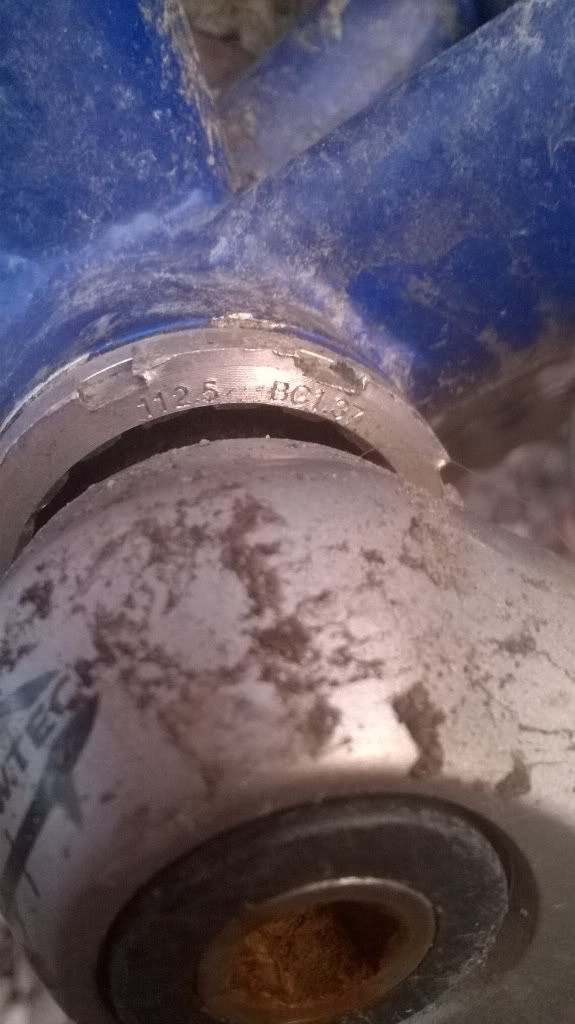

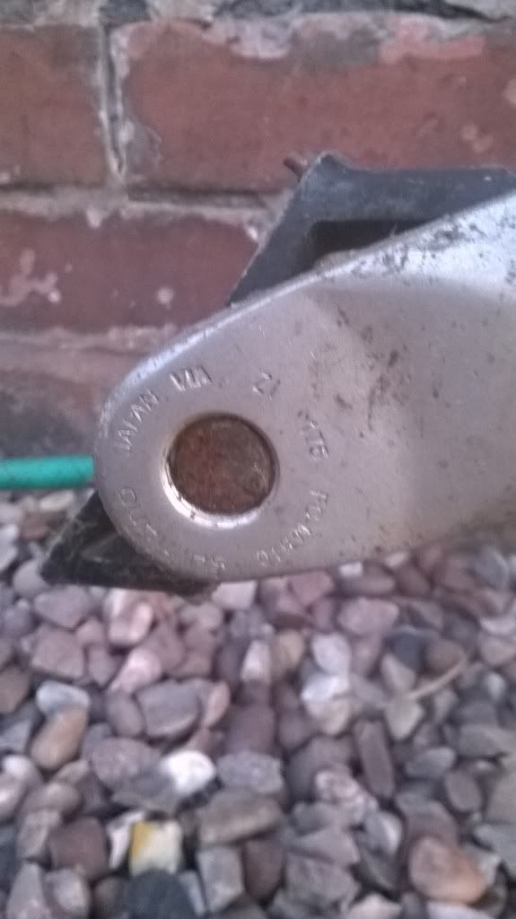

C collie Dirt Disciple May 21, 2014 #9 ok chaps, taken some photos, are those cranks too short? 175 . its a 19" frame i think and i am 6 1-2 fcm510
