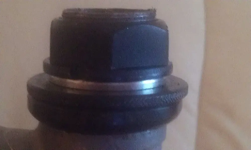

Possibly sourced what I need - however before I take the plunge I need some help. I rebuilt the existing headset tonight to take measurements.
With bottom & top races in situ and all parts of the headset installed:
From the top of the headtube to the top of the fork = 29mm. This includes approx 2mm of thread that is showing (hence the crappy plastic cover to hide the ill-fitting headset)
From the bottom of the adjustable race the top of the locknut = 19mm. Again with the 2mm of thread showing.
So the Top race is 8mm.
From these measurements (in light of the 2mm of thread showing) what is the minimum and maximum stack height I can go to?
I've attached a pic of the ugliest headset in the world...avert your eyes if you are easily offended...

Normally a locknut has a shoulder at the top covering the end of the steerer thread, so if that bottoms out before you've got the locknut snug against the adjustable cup, you couldn't tighten it any more anyway. That is the "headset with insufficient stack-height for frame" scenario.. You'd need more spacer, which is not ideal. Your locknut is either unusual or damaged if it lacks this shoulder (which it obviously does). That shoulder is what accounts for the 2mm odd difference between my measurements and velobase's. You're not going to end up with threads showing on a normal locknut.

Yup, that's certainly an ugly one. :shock:

If you look at all quality headsets, the top nut curves over at the top and covers the fork thread to give a tight 22.2mm fit around the handlebar stem quill.
