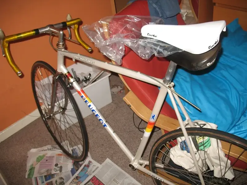

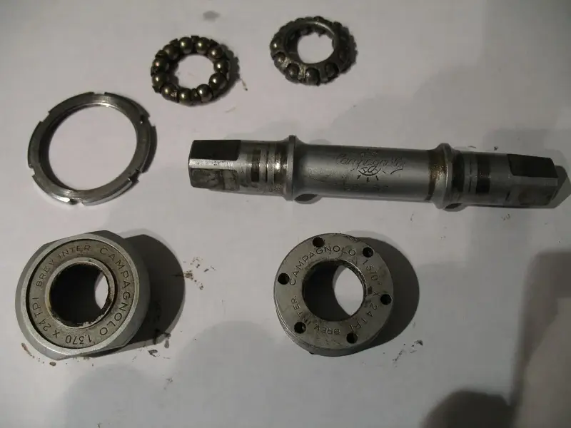

Bottom bracket removed, looks like a super record ? surprising easy for a bike that hasn`t been on the road in 20+ years .Everything on this bike has been so well kept and so well maintained so it`s coming apart beautifully. I am looking for a mint or NOS C-record chainset. The current BB spindle is 113mm but I believe the C-record would need a 111mm , can anyone confirm this. I have also bought a white turbo saddle and am intending to dye it orange as would have been fitted originally . I will be experimenting with an older white saddle first, has anyone ever done this ??. I have some very nice C record brake lever on the way with almost immaculte white hoods. I reckon it may take me the rest of the year due to financial restraints but it will be well worth the wait.

Bottom bracket stamped 68-SS and cup design looks like a later 1045 Nuovo Record trying it's ancestry back to the 1960's

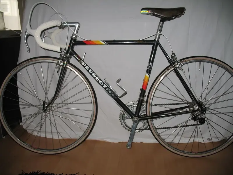

531 Pro is a great frameset and have never understood the views that it's fragile and not resilient. One of my sons uses a 531 Pro as his runaround at uni in Leeds, and when I say 'runaround', he was a good mountain biker in his time and still enjoys jumping kerbs, running up and down steps, etc, but the only bits he ever breaks are the wheels, the levers and the derailleur. The one I run, admittedly not that often these days, a slightly less firm ride than 753 and great for easier days. Here's a photo:
Good luck with the build - a stunning frame.

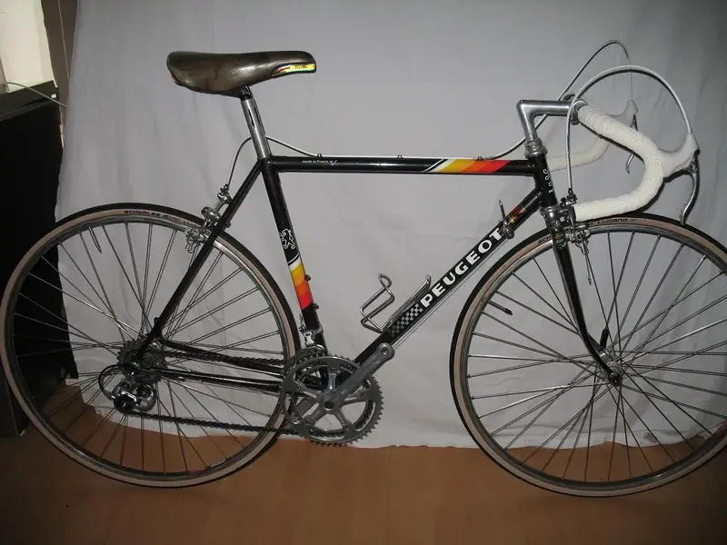

Nice bike, I had another 531pro which I sold on ebay last year and instantly regretted it.I gave it a quick makeover before it went including new lever hoods. It had full Mavic SSC groupset so its nice to be looking for Campag bits this time . I do love these old Peugeots.

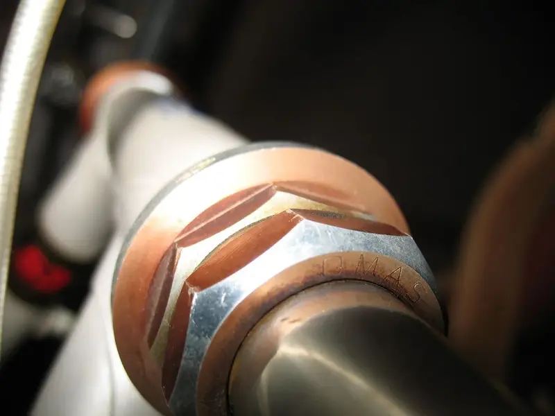

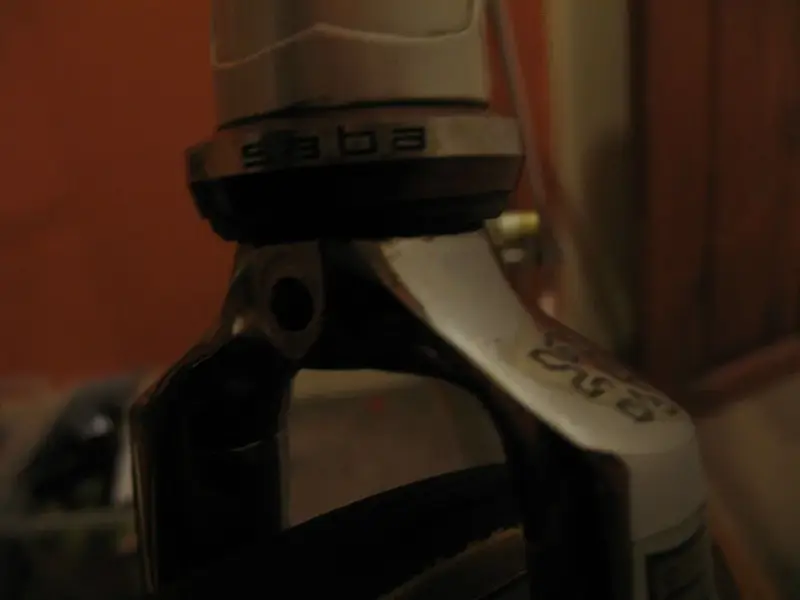

Omas Saba headset on the ANC is smooth as silk, no play in it whatsoever , nicest action headset I have ever owned. I was not familiar with Omas but after a bit of googling it seems they were pro spec back in the day and were considered to be the best even better than Super Record ? . they seem to fetch silly money on ebay, so I will be keeping it on. It`s just more evidence that this is not a run of the mill Peugeot and increases my belief that this did originally belong to the ANC team.

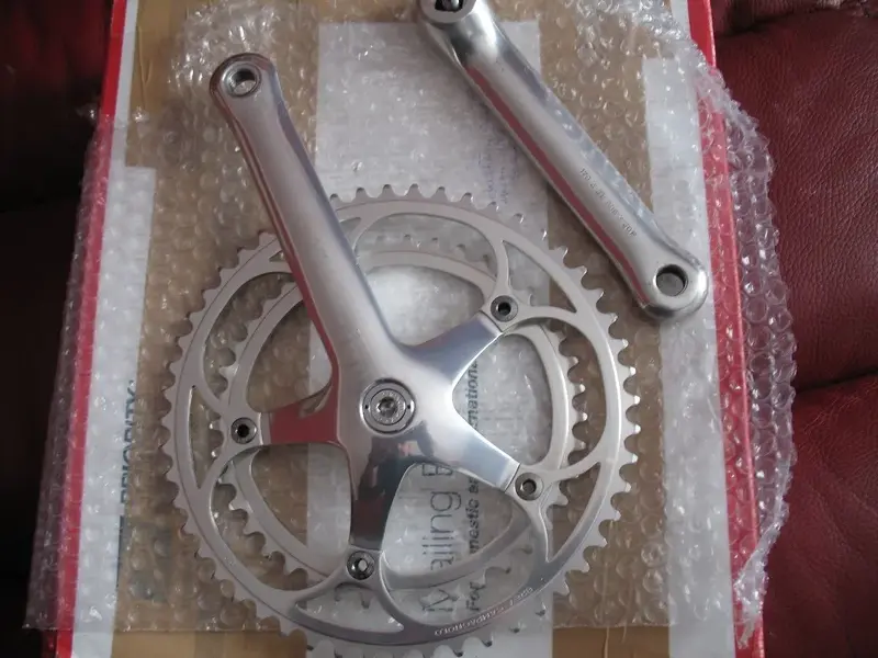

C Record chainset purchased and arrived from the great ebay . Not new but very very nice and little sign of use, will compliment the bike perfectly.My only concern is the current BB which I have just cleaned and fitted new bearings to is 112.5 axle and I really need a 111mm C record one , it will have to do for now as I can`t wait to fit the new chainset. I recently bought C record brake levers and some fabulous mint Chorus brakes ( just cannot afford a mint set of cobalto brakes and the Chorus brakes look so much better ). photos to follow, I am so excited about this build :-)
