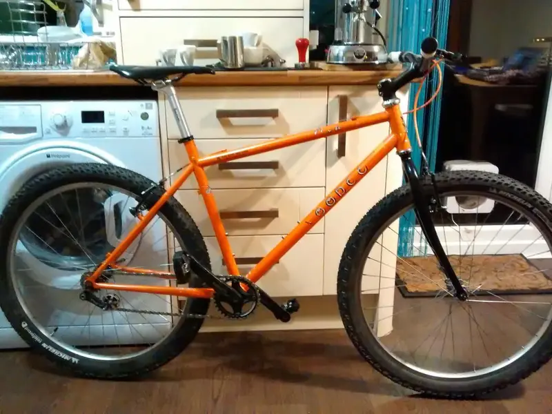

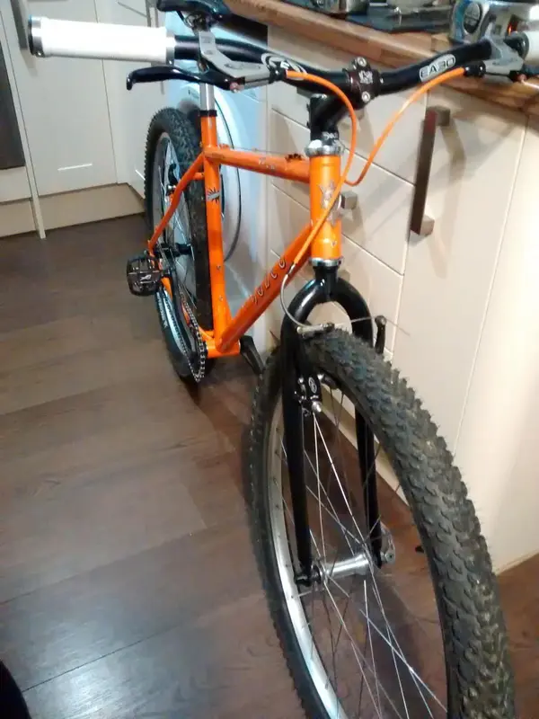

For those that would like to know:
Frame and Forks: '97 Voodoo Erzulie
(well I believe the forks are also that era, apparently it was 97 only when the Orange colour was done and the original colour of the forks is orange)
Rims: Araya
Front Hub: WTB Momentum Grease Guard
Rear Hub: Shimano Silent Clutch
Brakes: Avid Single Digit 3
Levers: Avid Speed Dial 5 (I love these levers. Totally rebuildable)
Seat Stem: Tahoma
Handlebar Stem: Kona
Bars: Easton EA30
Grips: Clarks. White. Very white.
Cable: generic supplied by Black Dog P.
Seat: SDG easy wipe.
Crank: M440.
Ring: Hope Thick Thin.
SS conv: Surly Singluator.
Tyres: Michellin Mountain Dry 2.

That looks a great fun bike to ride but i'm a tad jealous over the colour as it looks good enough to eat Yum!! ;) ..
Aye. Thanks for the comments of appreciation. The forks are a good find. Had a ride to bed everything in last Saturday (see pic) to make sure everything was ok. Turns out the rear sprocket was just worn enough to cause the chain to jump (I can't run the Singuleator the opposite way due to the chain length half a link too long) and the headset was notchy.
Ended up with a puncture due to the Schwalbe Rim tape on the rear shifting slightly and the tube seemed to had split on the edge of it?!
So new black FSA headset, Lite Stick stem in black and Surly Cog later and all is well again.
Think black wheels are in order to complete....I did see a hope single speed wheel on ere somewhere....

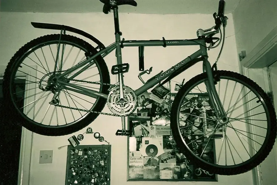

here are your forks on the original bike - it was sold on with some Manitou xvert after this B&W piccie
