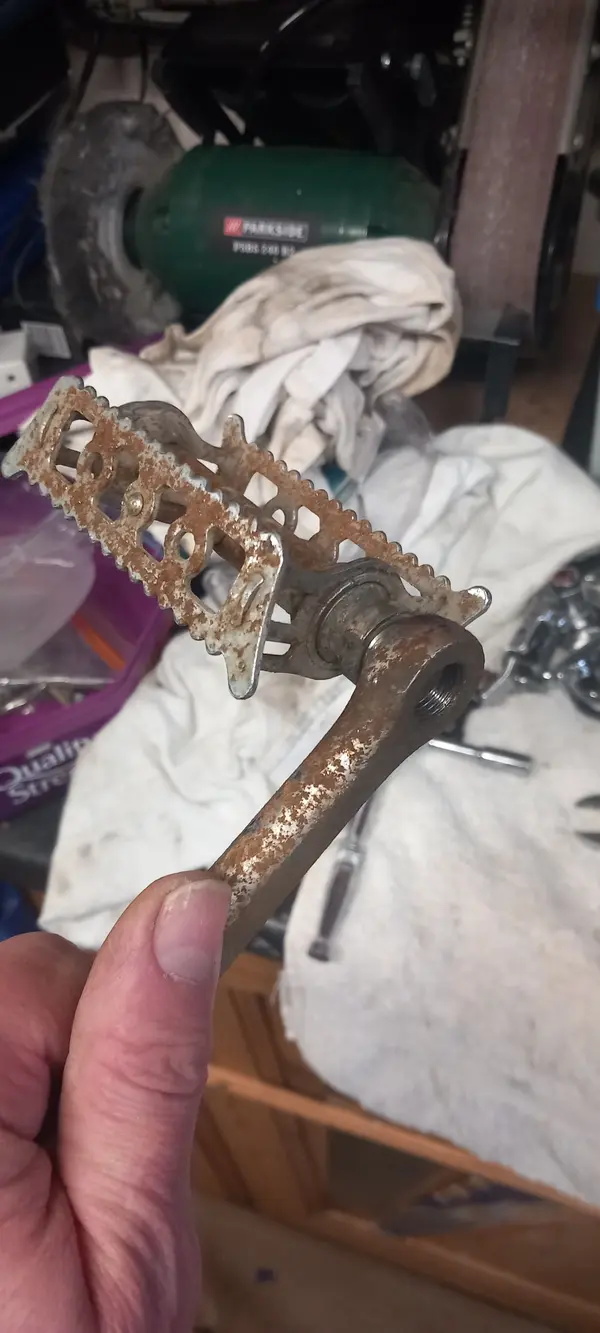

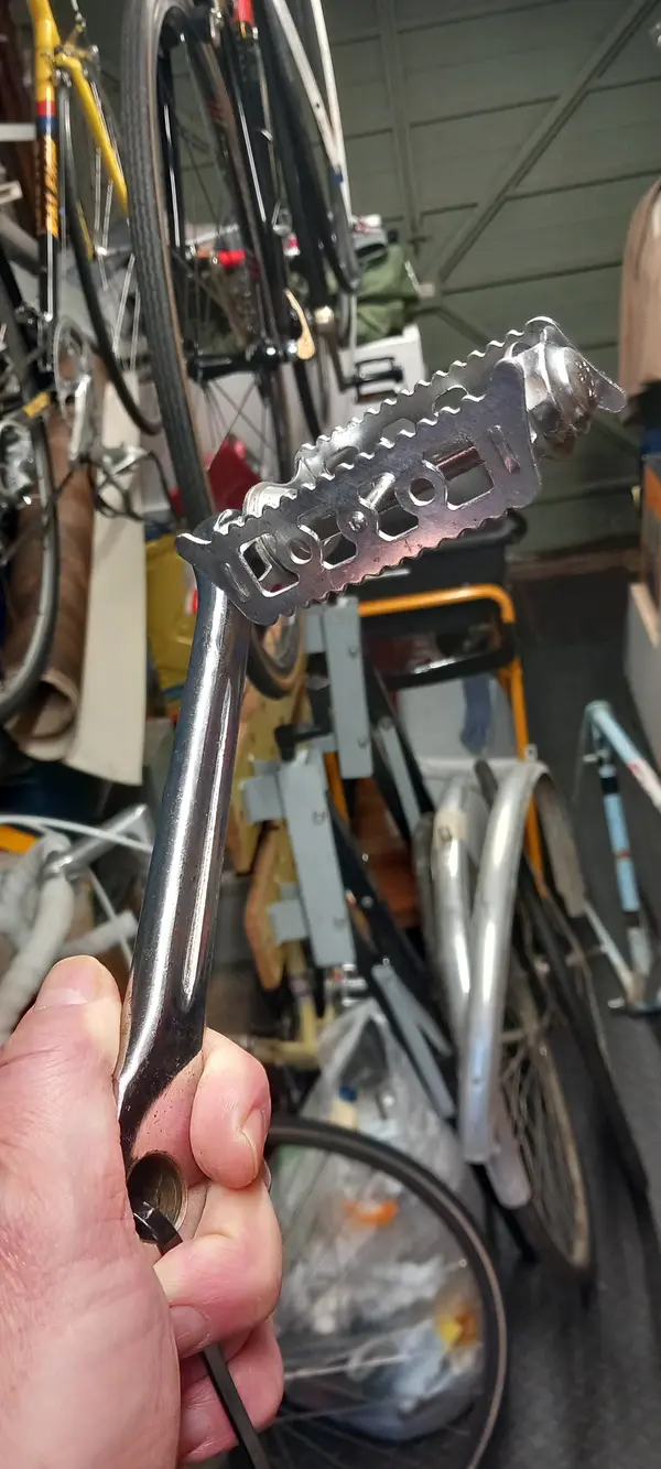

Ernie Clements 531 Falcon San Remo (finished!)
Great job so far rescuing those components, it may take a lot of metal polish to get the crank set etc back to a shine buts it very possible, see my thread here https://www.retrobike.co.uk/threads/ernie-clements-build-thread.483117/

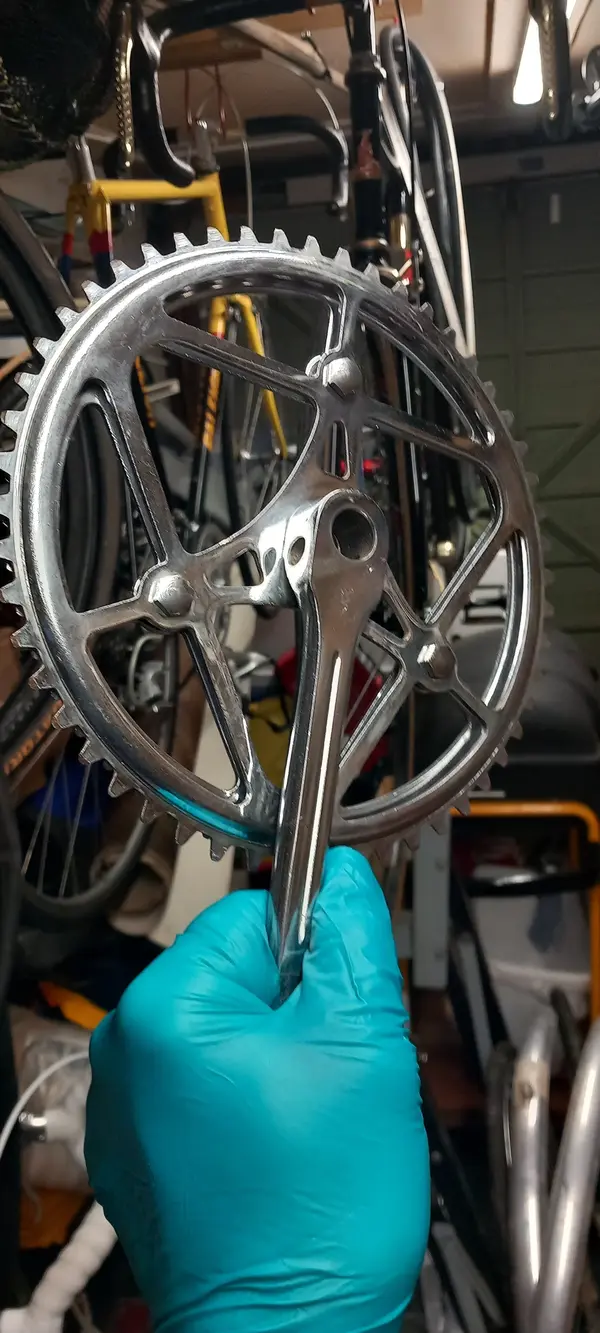

Today I stripped both sets of brakes down. A 610 and 750 and all I found stamped on them was 610 and 750! No date stamp which I was expecting to see. Were early ones not dated? Had a look at other components with no luck either. Maybe the brake levers (which I haven't stripped down yet) will hold the answer.
Nicklin or Williams spring to mind, can you see the logo? Typical 2 tooth difference in chainring size for 1972 :)
