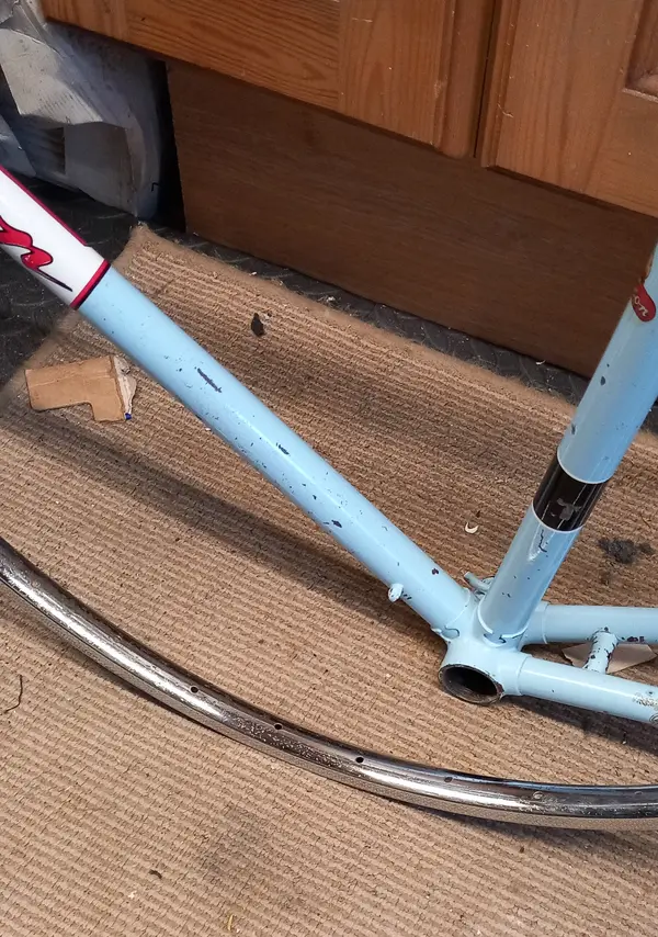

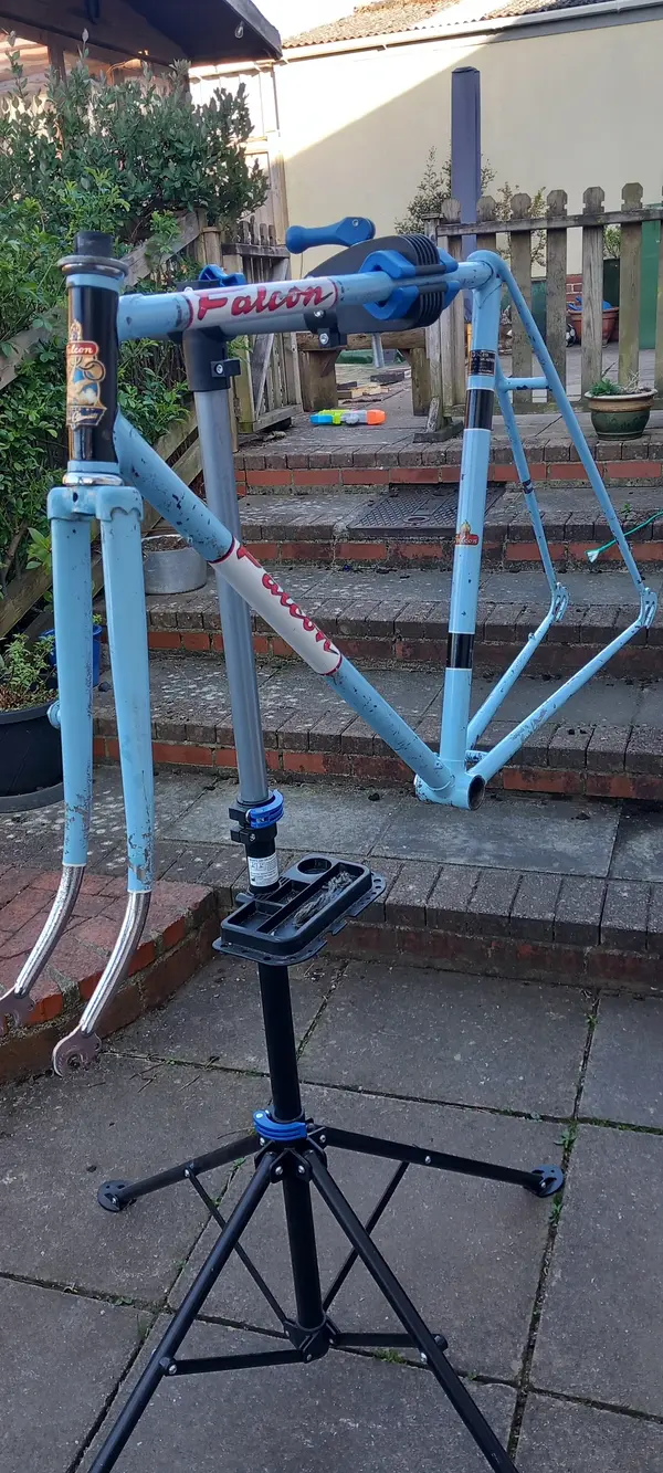

Had a good day on the frame today. Gave it a good wash and then started on the rust with T -cut. Pardon the pun but that was not cutting it so I carefully applied Farclea G3 cutting compound with a gentle rub of wire wool. This removed the rust and has left me with a decent patina on the rest of the frame. I've not done a preservation project before and I'm quite liking the cared for not cared for look! Well it is 50+ years old and original so not bad considering.
G3 and wire wool, interesting combo, and it didn't scratch the paint?
I can imagine it's powerful combo.
It was fine wire wool and had the effect of polishing the paint really. It was quite dull before I started and only a light wax aftewards brought it up quite pleasingly. I would say it's a fine line between taking the rust off and going through the upper paint layer though.....needs a gentle approach!

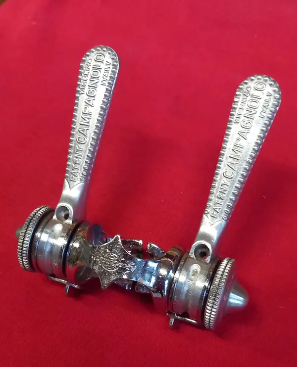

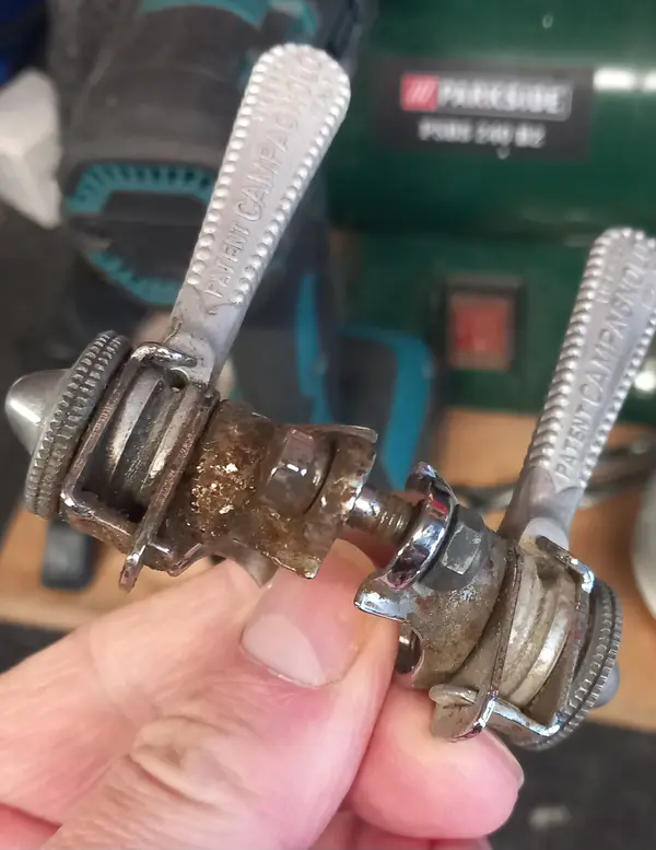

Downshifter time. Pretty gummed up with crud and poor movement plus the obligatory surface rust. All stripped, cleaned with soap and fine wire wool. A small smear of oil on the friction surfaces sees this working like new. This may have been the cheaper components Campagnolo were turning out at the time but they were still quality items. 1000009938.webp 1000009944.webp 1000009945.webp
