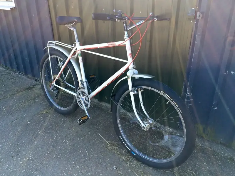

I own this completely original, unrestored English Cycles Metro-Trekker. The frame is identical to the Range-Rider but was fitted with 26" wheels, cantilever brakes and bull-noose handlebars. It is a Cleland frame fitted with US MTB wheels and componentry. Fitting 26" wheels to a frame designed for 650B gives very generous wheel/frame clearances.
