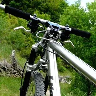

I don't think so, but just because of the black anodising and the more chunky look. Just doesn't look like Fournales stuff. It does get the bars lower, though, as you don't have to mount a stem above the top clamp of the fork. Found another pic on a different bike, which seems to have an upgrade coil shock, also:

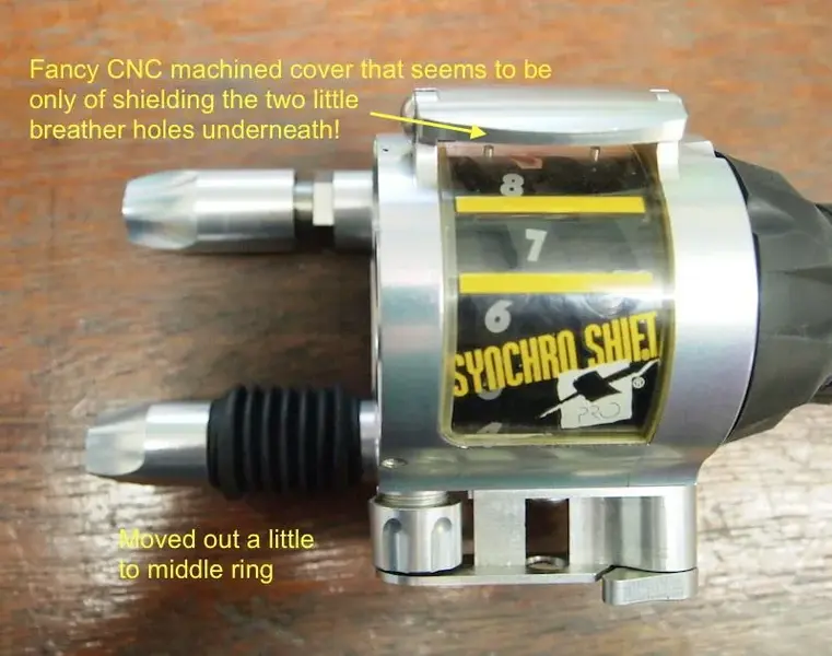

wow! is the front mech a dedicated one too, or can you use any front mech? and how does the whole setup work?
As far as I know it hasn't got a dedicated front mech. I hope not, as that'll be another part to search out :shock:
The shifter is supposed to work with any rear mech (presumably not SRAM 1:1, though), not just the UpCage.

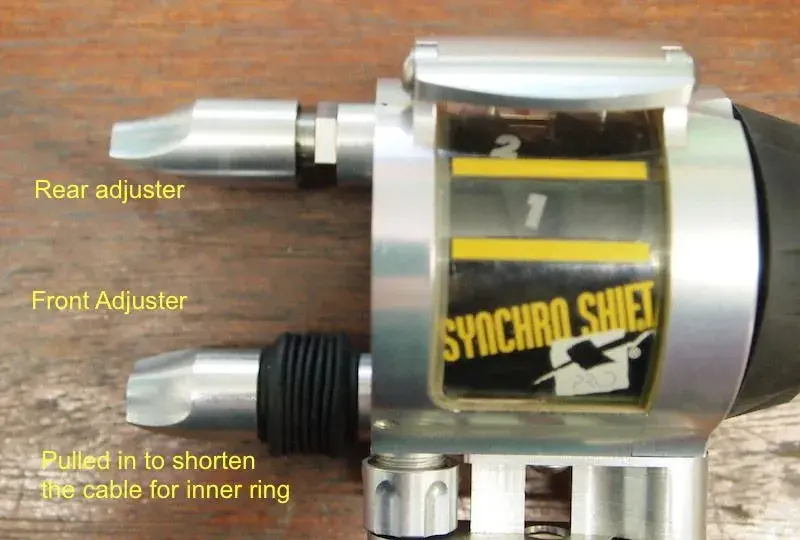

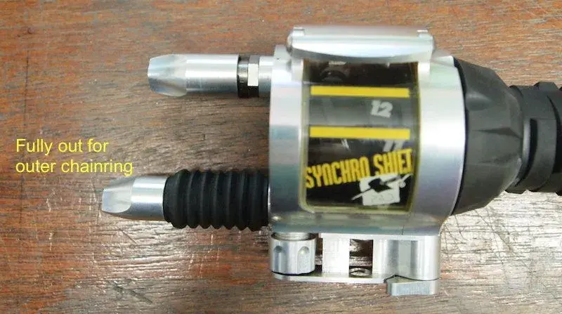

There are two cable fittings: The top one is for the rear and the cable nipple is pulled in a straight line inside the barrel of the grip. The front mech side (with the rubber bellows) changes length, pushing the cable outer instead. Both mechanisms are operated by a profiled drum inside the fat part of the grip. You can see the guide grooves through the window:
The shift mechanism doesn't fully rotate like a GripShift or Rohloff grip, rather indexes like an trigger shift: down and back to shift down, up and back to shift up a gear.

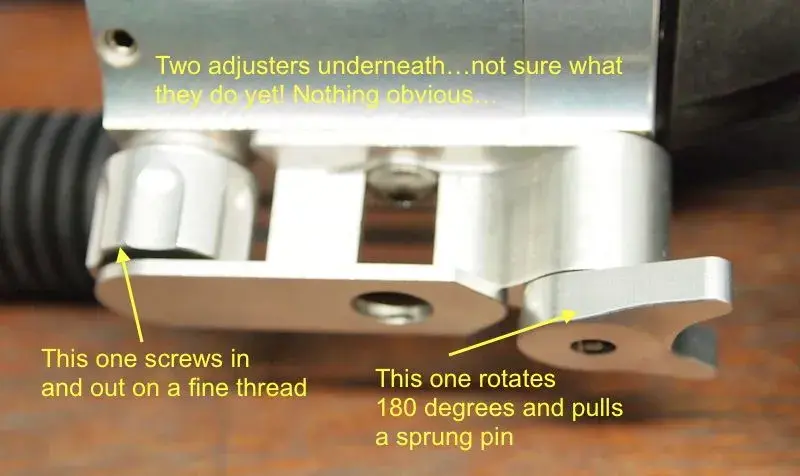

Any ideas what the adjusters do?:

"which seems to have an upgrade coil shock" I know that Litespeed bike with the Fournales fork, seen some other pics of it. The shock is still the same but it looks to me like the owner retrofitted a fork boot to fit over the stock shock, that's why it looks different. I think the integrated stem is a legit OEM part even though it's black anodized.

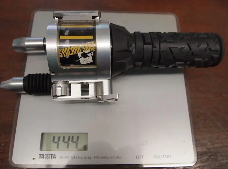

That shifter mechanism is something else! Over-engineering to the highest degree. Reminds me of a Curtas mechanical calculator... is it heavy? (looks like it would be quite hefty)
A shock boot would certainly be a damned good idea for the Fournales fork, since the seals face upwards and just catch the crap. I do like the integrated stem, though. Must look out for that :D
Hmmm... I suppose it was aimed at downhillers:
444g...Not too bad, though, when most pairs of shifters are in the 250-300g/pair range, not including the grip itself (subtract about 70g for the EGS rubber one, it's hefty).
I presume the plastic version of the Synchroshift would weigh less.

444g isn't too bad, not great either. I'm looking forward to some real world riding impressions of this group-set. Do you have the installation instructions? I can imagine that it would be quite a challenge without.
Oh and the cheapo plastic version... hell no! (might be lighter but looks crappy)

Does the fine thread adjuster adjust friction / resistance to combat cable pull from the mech ?
Maybe the other locks it in a gear or reduces the selection to a range of gears ?

So the adjuster screw controls how firm the indexing notches are.
The pull pin changes shift mode from 'click and back, 12 spd' to round-and-round (Gripshift) 3 or 4 speed. Not sure why you'd want that :?
