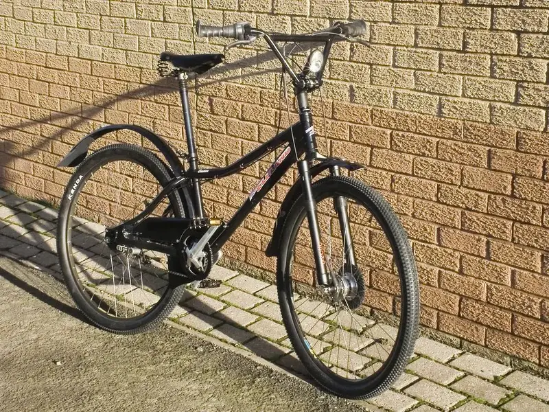

The Cleland - Twenty Ten in the flesh :oops:
It rides like a good classic Cleland or Highpath. But the brakes and gears are much more refined. The lower crossbar makes the high bottom bracket seem less intimidating, especially when you need to bale out in a hurry.
