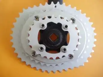

The only alternative at the moment are Osymetric who make 24-34-42 Chainsets for mountain bikes. I would imagine they're not cheap either.
Ahhhrrgh, my round conditioned brain can't get past the fact that "look" wrong. :oops: It would be great to try the egg rings as I have always been a spinner as it feels more efficient than pushing bigger grears (and seems to have less impact on my knees). If anything makes cycling more efficient I'd like to try it. £90 per ring and then a new chainset seems a bit beyond reach though. :(

Those Osymetrics look suitably oval, but I'm not sure the orientation is right... better than Biopace though...!
