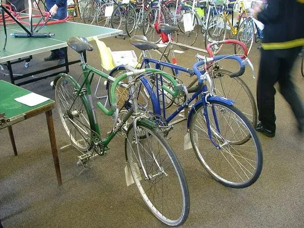

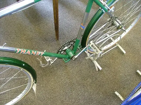

This Silverlight (which must have cost an arm and a leg to restore) was on display at this year's Classic Show. The triple triangle and 'inset' BB show clearly.
Note also the unusual 'Waller' frame next to it.

I still say the Silverlight (not very light) was rubbish. Never used by racers, the 1 inch tubes very under specified.
The frame here is clearly a Silverthan, but all the "lugwork" of both models has pressed "T"'s brazed on, not part of the lugs.
