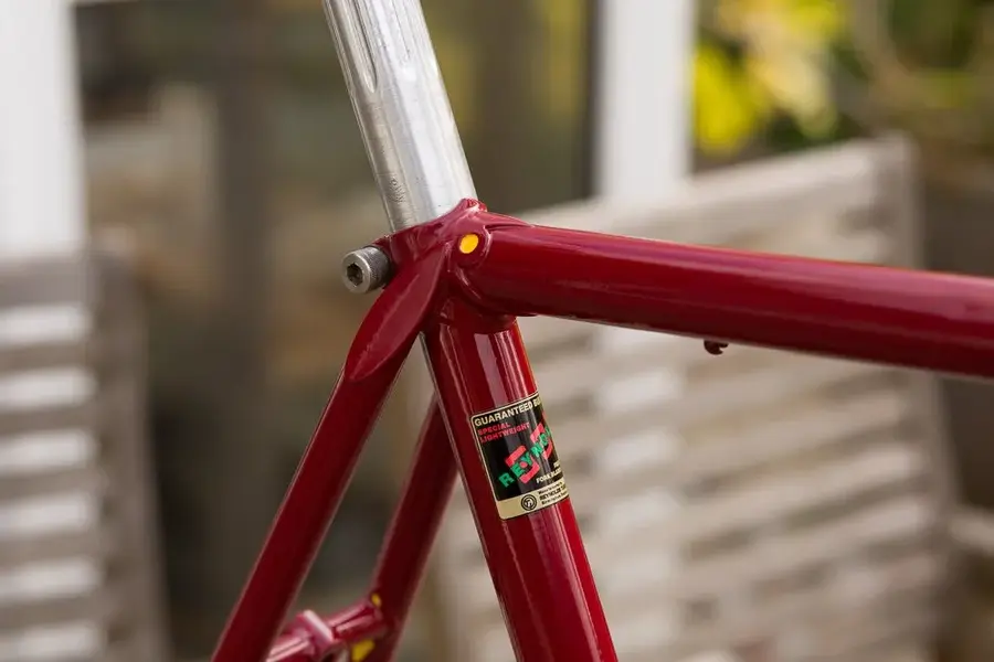

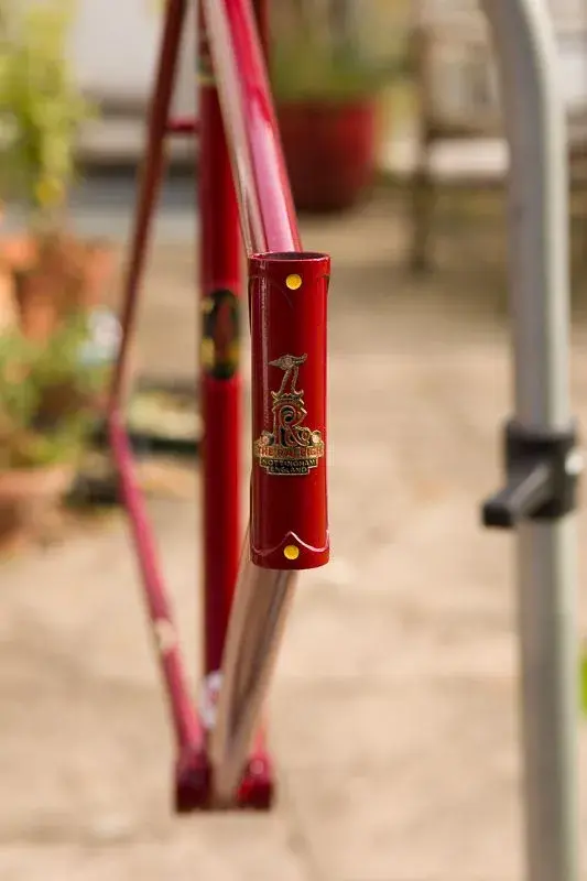

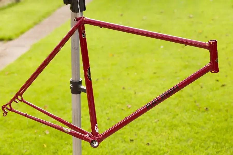

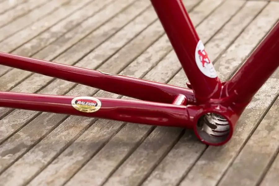

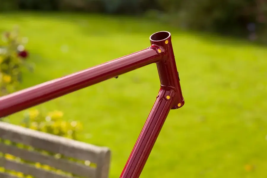

Back from the paintshop - something a bit different to all the Team Pros out there.
Crimson enamel, with golden yellow highlights from Bob Jackson, transfers from Nick T. The transfers are repros of the early time trial specials and other special builds, and since the frame came with headbadge drillings it now has one and not a second foil transfer.
It's come up really well considering its original state. There's a bit of pitting and the odd small dent but nothing much to take away from quite a special frame. The flat rectangular shape of the wheel clearance space in the chainstays, plus the 27.2mm seatpost confirm the 531SL tube set.

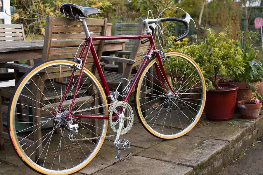

In the spirit of being a bit more original this won't be a SuperRecord throughout build but rather a sympathetic refurb with a mixture of appropriate period 1976-77 parts and modern components that will give this another 40 years. I'll start a build thread in Readers' Bikes :D
