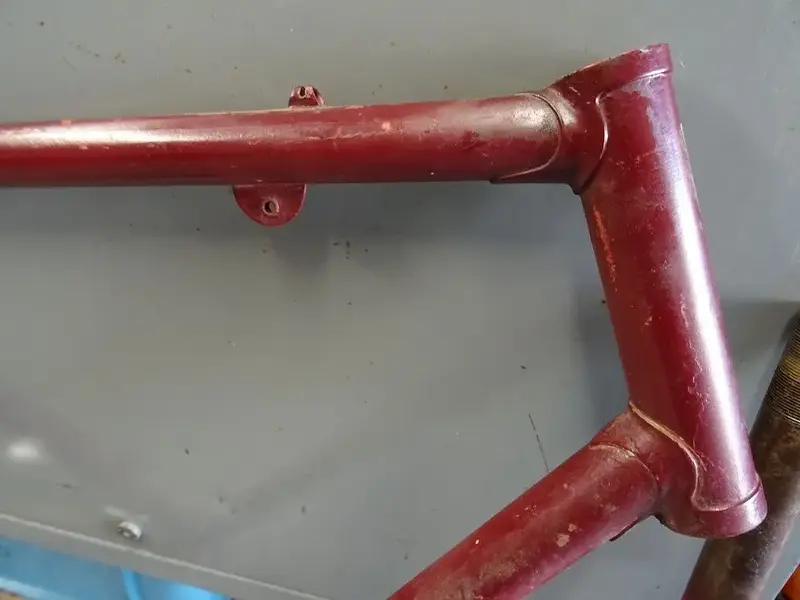

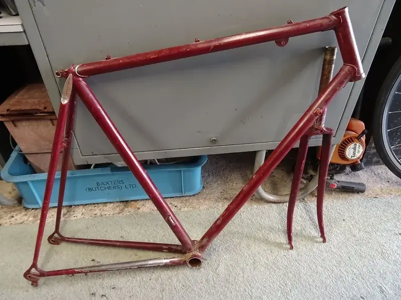

Picked this up on a bit of a whim, it was local enough, my size and I was the only bidder, always a plus!.

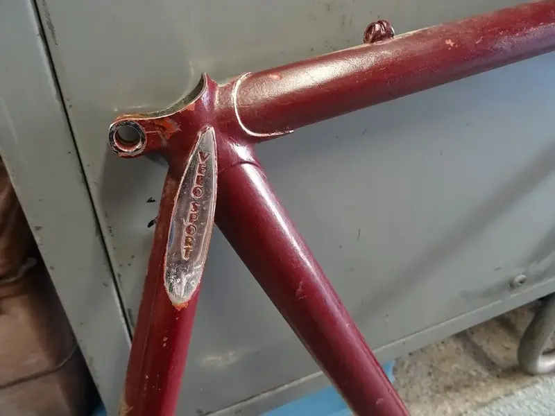

The thing the first caught my eye was the rear stay/seat tube cluster and the race number hanger, I thought they looked classy and hopefully spoke of a quality build, despite the paintjob!.
Having got it home, I've stripped it down to get a better idea of what I've got. A few of the components are going to stay but this is going to be a bit of a slow-burn restoration, as and when money and time are available.
There's not a great deal of info regarding velosport frames available on the web as far as I can see so if anyone here can shed any light on it's provenance it'd be appreciated.
It appears that there are areas of chrome hiding beneath the horrible paintjob so the first task is to strip away the paint to see where they are and what their condition is. If you have a recommendation for a good paint-stripper i'd be pleased to hear it.

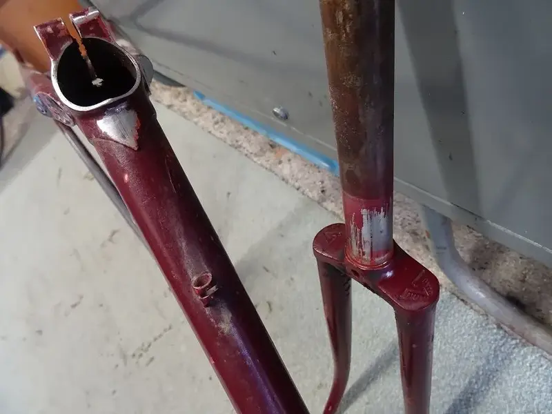

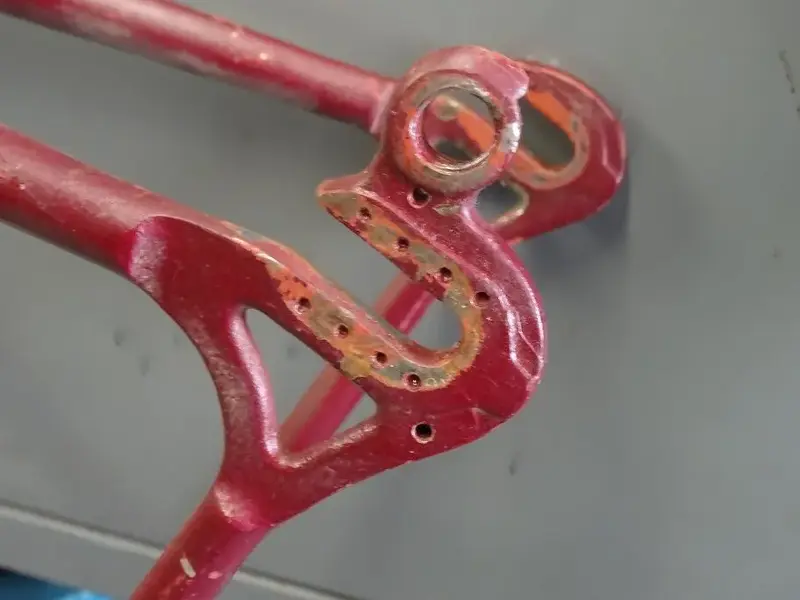

Build-wise the frame is 55cm C-C square, has Campagnolo dropouts front and rear, it has a nice cast SABA bottom bracket which may also be chromed?. The frame weighs 2020 grams and the forks 675 grams, so my thoughts on tubing were 531c which seems plausible for the frame but I feel the forks are too light?, what do you think?. The serial numbers on both match.

Possibly made by Viber so likely Columbus sl. Check seat post size carefully 27mm rather than 27.2 of Reynolds. Portacena drop out and rear spacing will narrow build year.
Chromework indicates quality frame

Interesting thoughts on the tubing type, the seat tube diameter is spot on 27mm on my verniers now it's empty, but it was fitted with a 27.2mm post that didn't seem tight and came out with no issues.

I have a Campag. two-bolt seatpost pantographed with exactly the same logo as that on your seat stay caps.

....bit of a thread bump here, but over the summer I had the good fortune to meet a chap that had worked in Velosport for many years, in a bike shop in Colchester.
He was able to give me chapter and verse on these framesets, so I thought I would record it here for posterity (and whilst I remember it! :lol: ).
These criterium specific framesets were a special order through the shop in the late 70's to early 80's. They were generally built by Columbia of Worksop (although he thought a few were built at Bob Jackson), using Columbus SL tubes except the down tube which was from a 'pista' specific tubeset for increased strength, if that makes sense. The drop-outs were Campagnolo and the lugs were Cinelli, including the B/B shell (making my SABA example a bit unusual?). Generally the framesets had a chromed rear triangle and chromed forks.
My frameset does appear to have a chrome rear end but it looks as if the person who gave it the rattle can respray roughed it up for a good key (i'm guessing the forks are the same) :facepalm:
