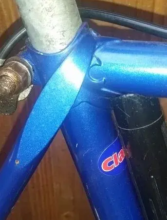

Picked this up yesterday another frame that I've been unable to identify. Frame number is also stamped on the fork which makes me think it was special order. E7163 is the frame number which I believe to be 1970. 2.1kg frame 750g fork. Zeus ends rapid taper stays. Any ideas? It's had paint and parts probably at some point in the 80s.

Seat stays are Flyer style; just not meeting in the middle, you could order the flyer with nervex lugs if you didn't fancy the Flyer lugs.
These special order frames are the most frustrating! I may get strung up if I called it a flyer. But I take your point, it's a full 531 frame nicely finished so not much else it could be really. I plan to add some colour to the head and seat tubes and apply period decals. I'll omit the flyer one though...
It came from oop north btw, and has Denton cycles decals on the wheels, it may of being purchased 2nd hand there by the previous owner.

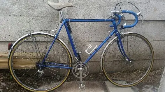

Then I find what looks to be exactly the same frame on here...
If either of those bikes came into our workshop for repair in the 70's with flyer wraparound and no decals they would have been identified as Carlton Flyer on the work ticket :)
