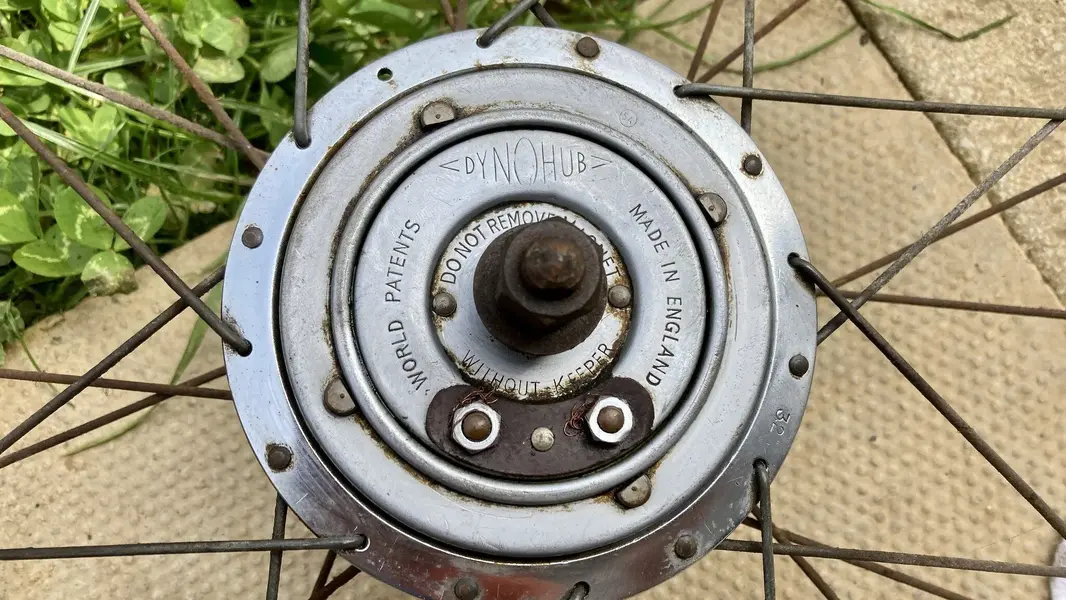

So in my quest to make the Carlton frame I was given roadworthy I stumbled across a steel rimmed wheel with a Dynohub laced into it. I have given it a bit of a clean, and tested it as per Sheldon Brown by holding a key across the contacts. I was surprised it still produces a spark. It feels a bit notchey ( not sure how to describe it). I haven’t had a chance to look at the bearing races yet, but provided they are ok my question is as follows:
Is it worth trying to salvage the wheel for this hub? Rim is not in a great state and all spokes are quite rusty.
If not, is it worth relacing it into a replacement rim? And if so would anyone be interested in it? I haven’t got the skills to relace it myself. Not looking to sell, but happy to donate to a good home if anyone can make use of it for a build.
They always feel notchy - it's the permanent magnets 'cogging' the armature. Modern ones feel exactly the same.
Thanks, that is helpful. Never had one so not sure what it should feel like. Will have a look at bearing races tonight. It is a nice piece of tech 😊

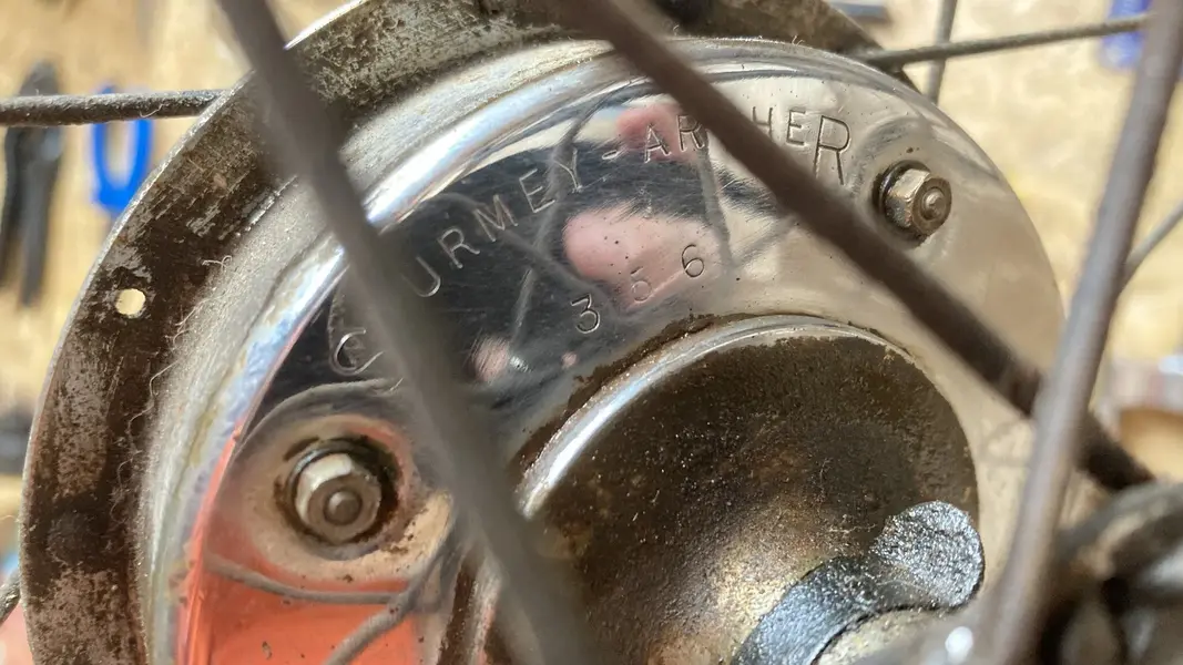

Just realised I may be able to date it by the serial number. Serial number reads 356. Following this guide I take that to be March 1956. Does that sound reasonable?

Be careful, IIRC they are easy to demagnetise, ideally you fit a keeper ring round the armature. But a quick peep inside and a squirt of grease is bound to help.
