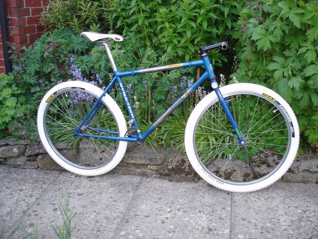

I think X-Lite posts were 25.0mm and they all used a shim to fit whatever size seat tube you had?
this one is defo 27.0 and stamped as such
the OEM post is also stamped 27.0
Maybe I misunderstood you. Thought you were looking for 27.0, but maybe you were in fact saying that 27.0 is the wrong size. he he.

quick update, just had a play with a 27.2 off one of my kids bikes
needed to bend the clamp bolt open a little with screwdriver but 27.2 will go in, snug as you like but goes in about 3" ok
looks like I need a new post . . . bugger . . . anyone know where I can get a nice one cheap? Whats the going rate for a nice condition 27.0 Xlite?

can I bump this and check with folks that 27.2mm is correct for a Royal Blue Dynatech Diabolo STX SE (I believe '95 has the blue paint fade to Ti on main tubes)
Got me a new 27.2 post (PlanetX Team 3D in white finish) and it only goes in 3" - so I figure this is probably right as a 27.2 post shouldnt go in a 27.0 hole
plan to get LBS to run a 27.2 reamer down to clean it up - so want to be really sure . . .
generally the min insertion mark is at 100 mm (4 in).
Can you see what stopping it going further.
It woukd take a fair amount of force tk stick a 27.2 post into a 27.0 mm tube, never tried it so it may not be even possible.
Is the seat tube steel? Id try cleaning it upl with fine wet n dry attached to a broom handle first.
Is it possible that the seat tube is bent?
