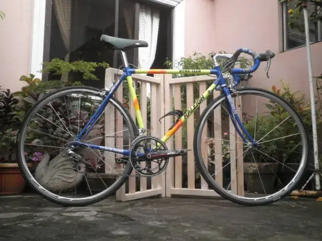

Just an update about my bike guys......
Within two years of riding it; having updated it to full dura ace 7700 the seat tube let go just where it goes into the bottom bracket lug......fortunately i did not bend the top tube (it happened when riding).
I believe it was a combination of the bad roads and the bike not being used for such a long time.
So i scrapped the bike; and seeing as i needed something new; bought a carbon fiber frame and built up a bike. Initially i used the 9 speed stuff before going the 11 speed route.....
Back in retirement..... (BTW the replacement is a Raleigh Militis 3, i custom built to my liking.)
