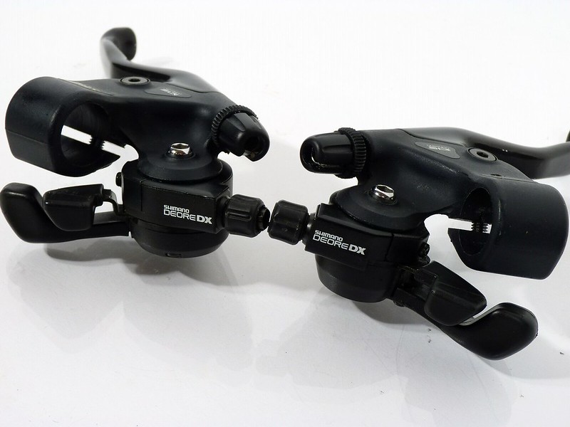

This model?

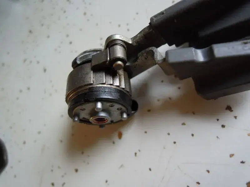

although not exact, the DX are similar to these internally. This shows you the indexing and the pawls that stop working properly due to the thick grease and sometimes corrosion from damp storage.
They are not my favourite shifter but the left hand one has multiple clicks which was great for front mech positioning/ chainline/ chain rub

Btypark":2ffc1tj9 said:
Hi folks
I've just fitted some old school integrated (sti) shifters and was hoping they would be indexed but it seems not. I have to feel my way through the rear sprockets rather than click and go. Is this normal for this age of shifter (1990)?
If so I'm happy to keep them but if there is something wrong with them it would be good to know :?
Do you mean like these:-
If so, they are indexed, but I suppose the internal grease may have gummed them up. Never happened on mine, though, I have a couple of sets (well DX and XT, and the XT ones look and feel identical).
Do the normal, first - check cables and adjustment, and see how the unit behaves with no cable tension - does it work as you'd expect with no tension on the cables?
