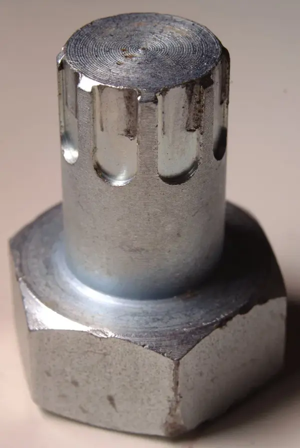

I wasn't that sure myself if the absence of the extra shaft on the one side of the tool would not make the tool useless. That was also one of the reasons why it took me that long to come back to this forum thread - I wanted to try it first. I also had an old wheel with a Dura Ace 8 freehub which I was not able to remove with the tool I made myself some time ago. The freehub was too tight, so I damaged the self-made tool (it was not hardened). So I bought this professionally made tool that I just recently found in Internet, fixed it in a vise, slid the whole wheel with the freehub over the "star" of the tool, and turning by the rim of the wheel, I was finally able to remove the freehub. Just before that, I heated up the freehub thread area of the hub with a mini gas torch just to make the outer thread expand a little (at least that's what I thought it would do). And even though I still had to use just about all my strength to loosen the freehub, the tool did the job, although you can see some very tiny dents just where the tool and the freehub had contact (see attached picture). However, as I wrote, I really had to exert my whole strength...
This is my experience just from a couple of days ago.
