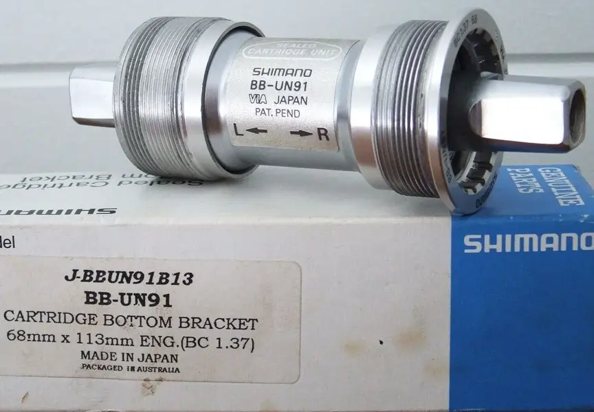

7400 groupset is 7 or 8 speed as I have 7 & 8speed D/tube shifters & 8 speed STI levers. So a 7400 BB 112mm will fit those cranks.
Basically Shimano just kept updating parts of the 7400 series groupset, i.e. Dual pivot brakes, Brake levers with return springs, etc also there are 2 different front Gears depending weather you use 8 Speed STI Levers or 7 speed D/T shifters.
The 7410 cranks came with a cartridge BB 103mm also Shimano updated the following parts as well. 7410 cartridge bearing headset, 7410 SPD Pedals, The 7410 long round seat post etc etc.
Hope that helps
The next major Dura Ace update was the all brand new DA7700 9 speed groupset
