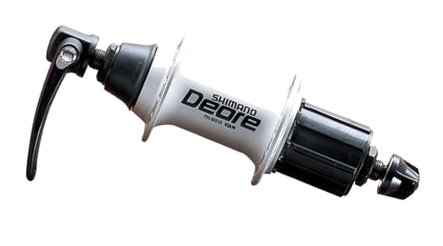

The question I have is what the title story, a work XTR M900 rear derailleur, Deore hub in FHM 510 and a cassette Alivio HG 51? All in 8 speeds.

Just to give you an idea on when they were available...
XTR M900 = 1992 - 1995
Deore M510 = 2000 - 2005
HG51 cassette = Contemporary 8 speed cassette equivalent to the old HG50 and HG70 8 speed cassettes available in the mid to late 1990's.
All functionally compatible.
