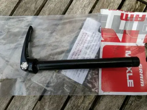

Is it DT Swiss specific? I have a SRAM Maxle ultimate 15x100 in as new condition going on eBay this weekend, £25 delivered if it will fit.

thanks they are funny sizes the axle is 143mm and has 17mm of thread showing which is 15X1.5 pitch
so I have ordered a new one from Singletrack in Fife for £30 posted
At that price it is a no brainer to get the correct item.
The SRAM ultimates are nearly £60! Hold the wheel in just as well as the standard maxle as far as I can tell, lol. Look nice though..
looks like they have changed the design slightly so the lever can stay or or be removed, i guess it will have the same problem if the axle cracks. Mind you the last time I used this bike was in Morzine and doing Ports Du soleil and I did warp my rotors that week, so maybe that caused the crack?
anyway I will start keeping an eye on my maxels just in case! the moral of the story - examine for cracks and chuck them away.
