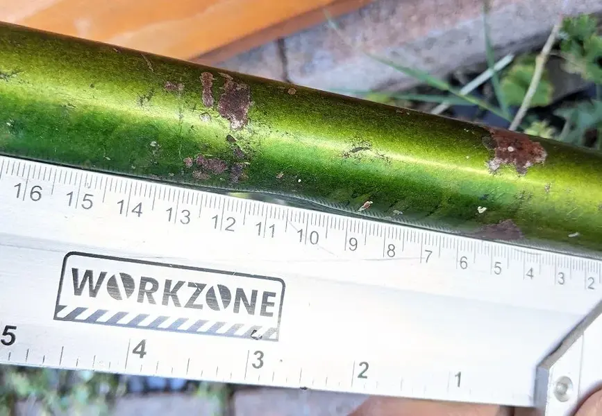

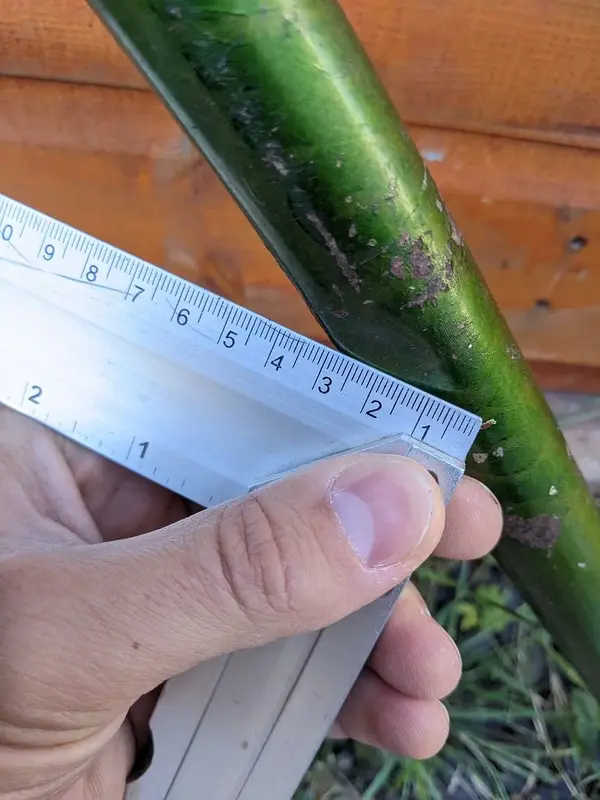

Dents in modern chrome moly tubing are hard to pull out. For my Claud Butler frame dents I bought frame tube blocks in the same diameter as my tubing (used by frame builders) to roll out the high spots on the sides of the dent. I used a pipe wrench to turn it around the dent as I gradually screwed the blocks closed. I used grease on the dent area to facilitate turning the tube blocks. After the high spots and out of round distortion have been corrected the remaining low spot would be best filled with brazing. If your not powder coating and using paint then acid core solder makes a nice and easy to work filler. Steel reinforced epoxy can also be used but brazing will work with paint and powder coating. I don’t see how the Sheldon internal expansion method would remove flattened high spots or out of roundness, but maybe.
https://www.paragonmachineworks.com/frame-building-tools/tube-blocks.html
Dent's about 3mm at the deepest point by ~2.5cm wide.
The DT is very slightly bent along its length, but I'm hoping that might correct itself once the dent is popped?
Tubing is almost certainly Reynolds 531 butted, so not cro-mo, if that makes any difference.

That is an interesting solution.
Will try to find these in the UK - shipping from USA costs about 3-5 times more than the block itself according to the sellers' quotes.
That's how I removed my dents 👍 with patience and pieces of paper in the right spot you can get it near perfect. I made my own ...have a look on eBay there's split clamps for allsorts of stuff you might find something with right bore or shimable with sections of thinwall tubing.it needs to match your tube OD tho.
DT is bent...hhmmm ...I've a feeling that won't come out when dent comes out...more straight edge action get a feel for what's happened to the frame....I reckon a cars reversed into it.
When I did mine it wasn't just a case of straightening the top tube I had to twist headtube at the same time.

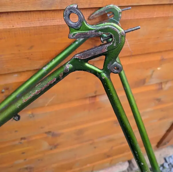

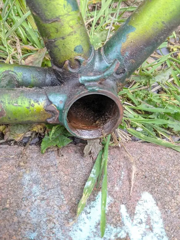

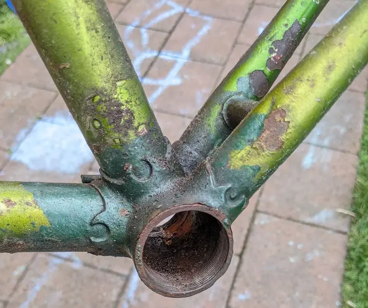

Frame stripped. ~2,750g for a size 57 frameset. That's what I call a lightweight!
Bike built in 1961.
Campy dropouts suggest this was closer to the top end of Scot's range. Although, there were no strict models and customers could buy an entire bike or just a frameset built to a custom spec.
Frame:
- Dent on DT as described above.
- Old repair of the cracked bottom bracket shell. No throw away culture back in the days (although, who'd throw away a Scot in their right mind)! Quick check suggests the crack was filled with brazing alloy, then re-threaded. Will need reinforcing me thinks: either braze a plate on the outside, or do a cf wrap.
- Minor dent on nds chainstay right at the bridge - pretty benign. Looks like a filler job or leave & forget.
- Minor dent on top tube. Same as the chainstay one.
- Seatpost unstuck & removed. Don't think there is any damage to the seat tube
- Rear triangle a couple mm out of true.
- Ds dropout bent out of shape.
- Adjuster screws bent & buggered but look like an easy extraction job.
- General alignment still to be checked.
- Rust condition is quite acceptable - very little visible rust on the inside, which is always a good sign.
Overall, I think the frameset is serviceable, unless more issues pop up.
