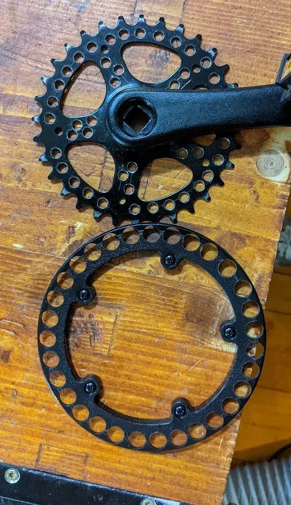

Hi All,
Building a weight weenie bike for one of my weans and the crankset appears to be a particularly difficult part to put on a diet. When magnesium and titanium are not available, it is only natural to start thinking of drillium.
I have a spare frog crankset in the right size, but the cheap buggers have gone for a riveted steel chainring. I'm no drillium expert, but I'm pretty sure that you don't need so much steel even for an adult's torque, never mind a young kid.
I know that the topic of drillium can be controversial, but putting the chainring on a diet has got to be one of the safest modifications one can make.
Is there a general guide to drilling out chainrings, i.e. how much material to leave? Never get within X mm of the edges, etc? Or should I just eyeball it?
Thanks.

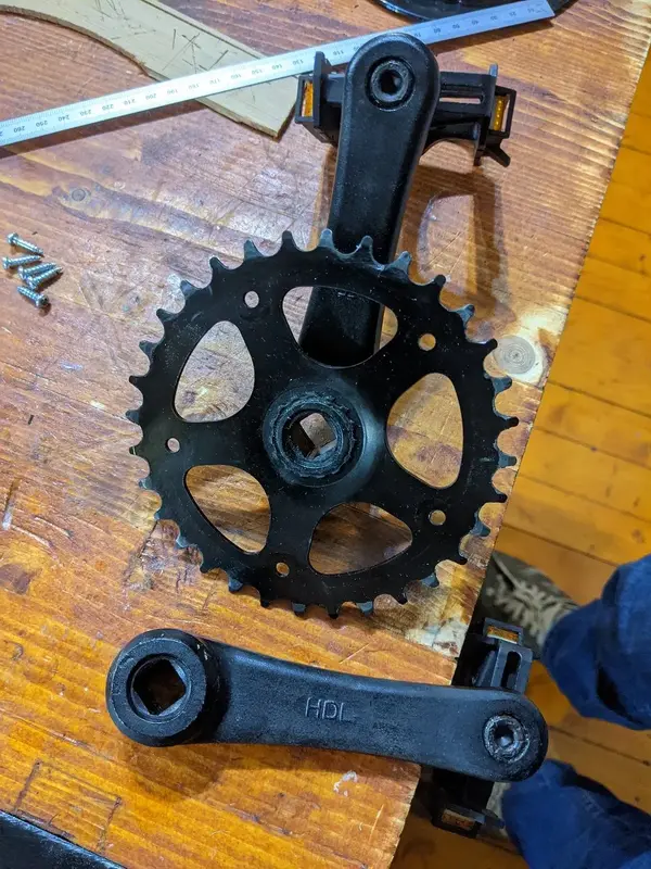

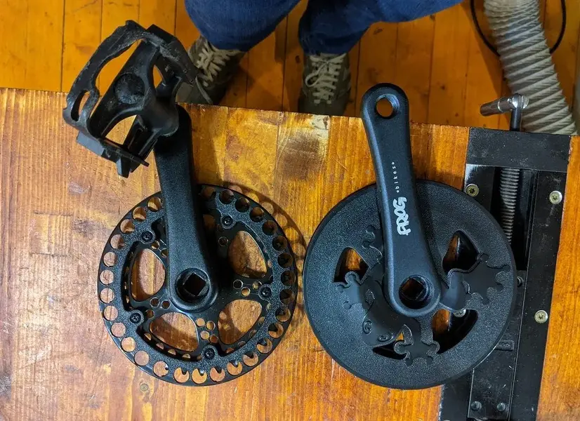

Well, I've got two of these frog sets, so I decided to go ahead and drill them. Plenty of thick steel left - I'll give them a very good kick myself, and if they can stand a 110kg gorilla jumping on them, they'll be fine for a 25kg kid. Will chuck the drilled ring out at the slightest sign of deformation.
- Ditched the back of the chainguard (33g)
- Drilled out the front of the chainguard (20g)
- Drilled the steel ring (20g).
Yes, I still want the chainguard, as the 13g it is adding is not worth the safety risk of not having it.
Overall, 73g dropped, which is not a lot, but all grams do add up. More than swapping an alloy brake caliper for a titanium one.
Right, I'm off to drill the mudguards.
