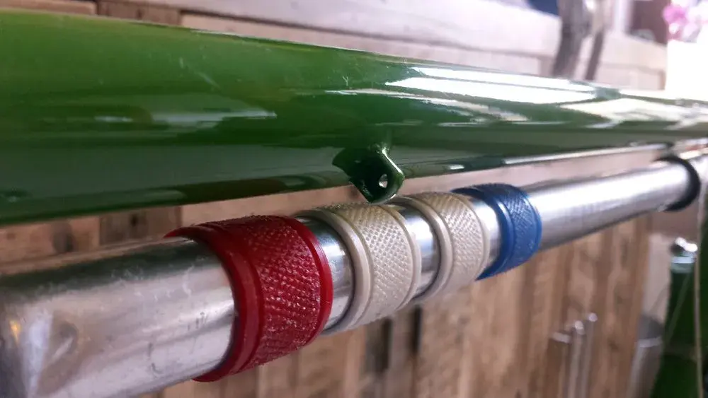

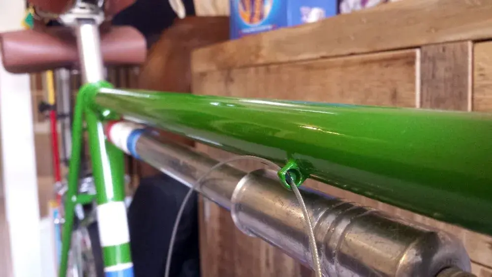

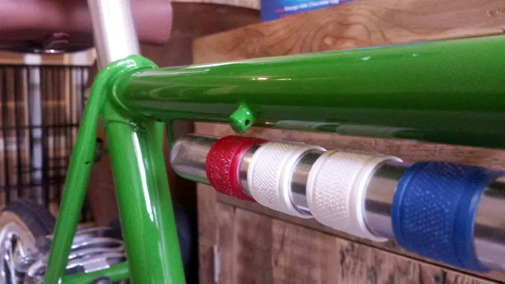

I have been supplied with some new, white, ribbed cable housing for my Sun Snipe restoration and it comes with some lovely shiny ferrules which look great.
Unfortunately the ferrules, when attached to the ends of the cables, won't fit in the cable stops. The cable (4mm) sits snugly in the ferrules which are 5mm wide.
Having looked at numerous pictures of Sun Snipes and Prestiges not many appear to have actually had ferrules fitted, the cable just going into the cable stops.
a) What are people's thoughts on this? I like them but they don't fit so are probably causing more problems with cable routing as they are at the moment.
b) Do you think the new paint job on the frame is preventing the ferrules going into the cable stops? Should I gently drill them out to be paint free? Or will they never fit anyway? Will drilling them out cause me problems with no paint being on the frame in the cable stops (this will be a fair weather bike unless Eroica Brittania is wet).
c) If I have no ferrules what is the best way of cleaning up the ends of the cut cables?
Thanks, as always!
Bob
Do you need a step down ferrule?
Have you got a PIC of the cable stop on the frame
Shaun
Hi Shaun
I thought about that (well they cropped up whilst googling - never heard of them before) but we must be talking tiny amounts of difference. I think the step would be too small for the cable stop. The ferrules I have measure 5mm and so do the inside of the cable stops as far as I can tell. Some pics...
Bob

Those are "proper" braze on cable stops and we never used a ferrule. Just work a small rat tailed file inside the cable outer to remove any snags.
Someone will come along now and tell me they should have a ferrule :)
Shaun
Edited to add, when you use wire cutters a small amount of outer cable gets bent, snip off the bent bit with the cable cutters using the tips of tje cutters. You need good cutters and we kept a pair for use on cables only. Nowadays people use a cutting disk and a dremmel
