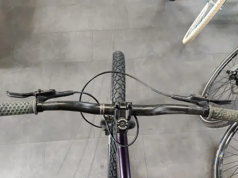

Do what I did and loop it around the steerer tube like a dirt jump bike. Not that I'll ever do a mad bar spin, but I didn't want to shorten the hose in case I wanted to move the brake to something else later.
