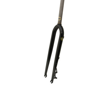

http://www.somafab.com/archives/product ... canti-fork
CRMO MTB 29ER/650B FORK
