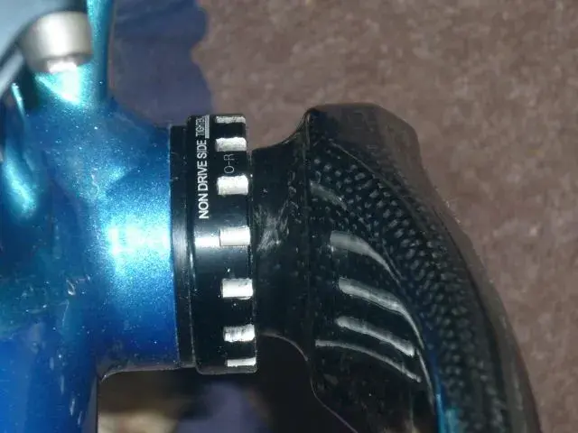

You dont get an axle, you get the cranks...they have the axle built on to them. External BB's will only work with suitable cranks. Shimano has its Hollowtech 2 range (current range cranks SLX,XT,XTR etc) Theres also the GXP system used by truative etc, similar idea but I think a slightly different diameter, then there is the new BB30 standard which is starting to creep in on the top end Sram XX stuff.
You cant use a standard square taper or isis crankset with an external BB, you must use the more traditional internal cups/sealed units.

Given all but a very thin bit is in the frame and with the lower profile cranks most of it is covered anyway. Pretty doesn't really matter.
The UN54 are reasonably light for a cheap bottom bracket. You'll need the correct length of course. Probably classed as inbetween LX/XT compared to the one's from back in the day and the weight.
Anyways, if you look there are plenty of others to get, again though for looks it's all covered up.

I'll be honest though, I have an SLX chainset on my old bike and the bottom bracket looks crap. black, with a few plastic spacers against a red steel frame just doesn't look pretty.
