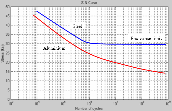

Ti is similar to the steel curve. http://en.wikipedia.org/wiki/Fatigue_limit
