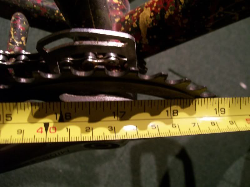

pictures make this easier :lol: . this isnt a dmr but the principal is the same , this bike was nearer and i can take the chain off easily . im also doing this one handed and its dark so the pics arnt great
ignore the chain
this one is likely what you will end up with , the gap on the left is large as the chainring is too far in . hold the straight edge away from the ring and measure the gap as its parallel . double this number as the bottom bracket remains even , ie if its got a 110mm and you need an extra 3mm get a 116mm as 3mm is lost on the other side , if you went for a 113 you would only gain 1 1/2 mm either side

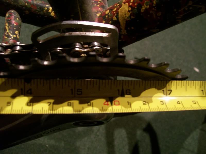

what it should look like is this , the straight edge runs along the ring . although ive taken the photo along the outer of the ring as its easier to see . correct chainline is against the teeth . next time i take the cranks off ill be cutting off that extra lump of chainguide :lol:
you have to put the straight edge along the chainring , if you do it sprocket tooth to ring tooth in the shortest points you have no reference . you can use string if you have it . you can pretty much guarantee string is straight when pulled taut
