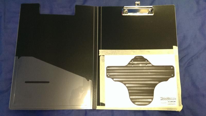

The site has a link to download a template, which I then printed off.
For the material I used a Tesco clipboard, stiff yet flexible enough to use, and only £2...
I soon realised I had massively overspent
I could make 4 of these guards from the £2 clipboard!!

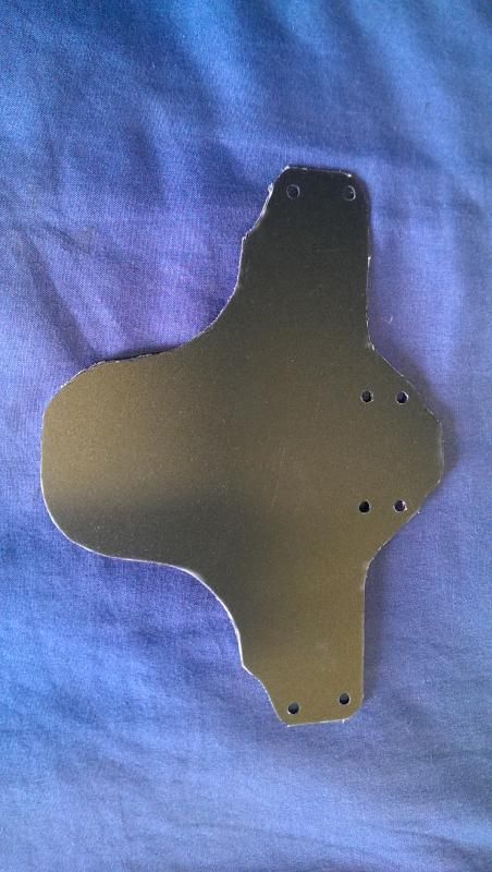

Next I taped the template to the clipboard and carefully scored around it with a sharp Stanley knife.
Then I cut it out using scissors, drilled the holes, and smoothed off the edges with some fine sandpaper...

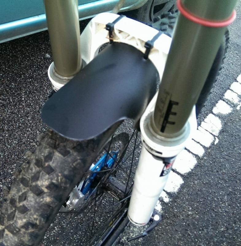

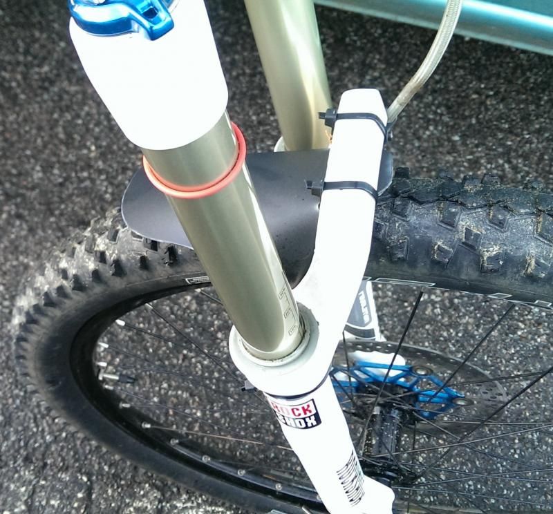

Four cableties later and it was fitted to the bike...
It's surprisingly good at stopping muck from flinging off your front wheel and going into your face, and it helps keep the fork stanchions cleaner, whilst managing to look fairly inconspicuous.
