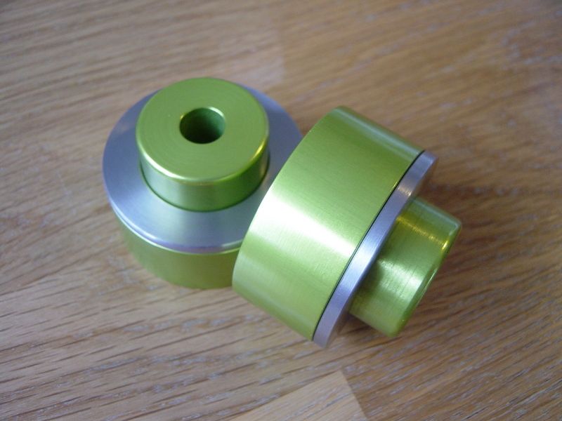

1/2" threaded rod, a few nuts, some large washers, a bit of patience - nothing else needed.
It's in a pretty shade of green now :lol:
oooooooh! is that homemade? looks nice! not sure about the green though :lol:
