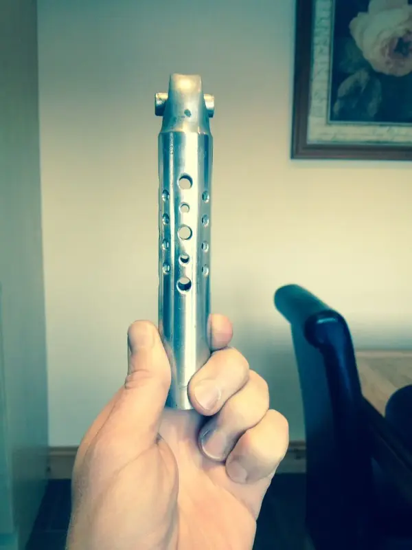

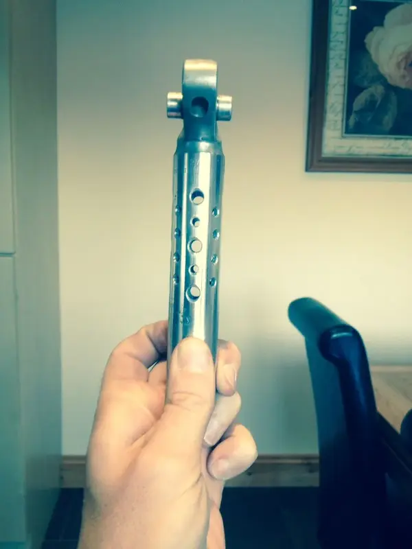

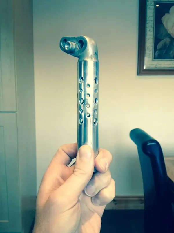

I've always been fascinated by drillium and with the roads to icy to go out and ride I found myself reading this pretty amazing thread;
http://www.bikeforums.net/classic-vinta ... phemy.html
With this and some strong Belgian beer for inspiration I dug out the battered Campagnolo seatpost that I've been wondering what to do with and got busy in the garage.

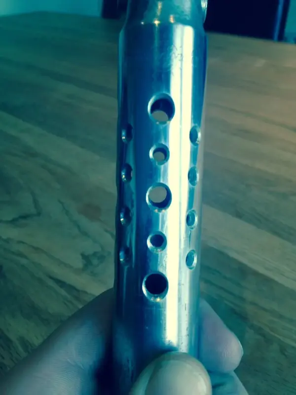

The bottom row of holes is a little off but overall for a 1st attempt I'm pretty happy.
I'm not doing this to save any weight, I'm just trying out something I've always wanted to do.

I doubt I'll ever use it on a bike to be honest. I left plenty of material on it though, compared to some that I've seen on Google.

Always use a sharp drill bit and very little force on the actual drill.
Let the bit do the cutting not by you pushing it through the material.
Use small pilot holes and small increments. I started at 2mm and went up in 0.5mm steps.
