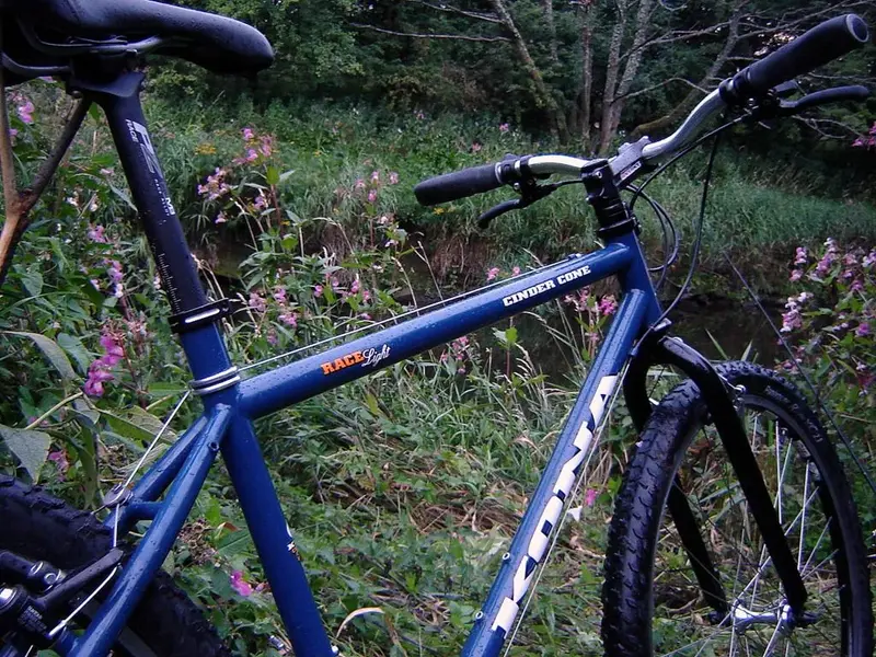

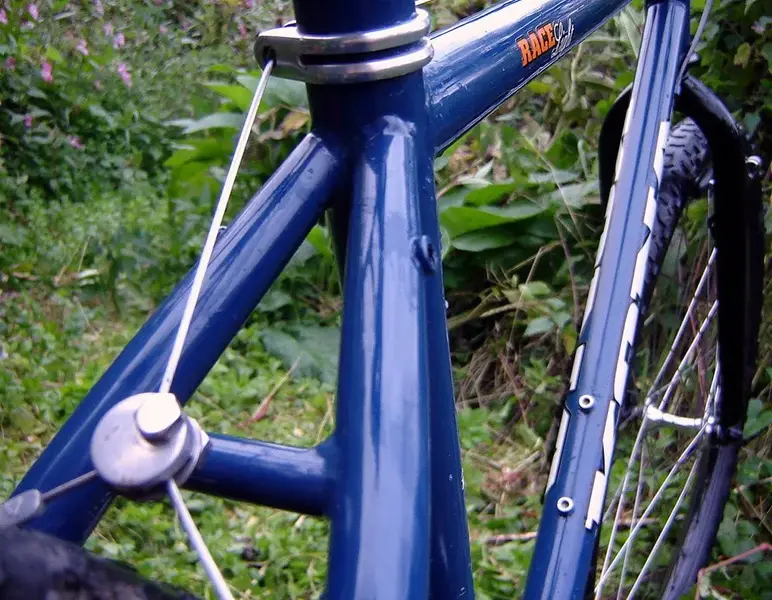

This is the fourth frame I've painted in three years; two spray paint jobs and two brush jobs. To get a decent finish requires patience and a light touch with the wet n dry paper. Rub too hard and you'll go through the paint, particularly on any edges.
I used 400 grit between each of the six colour coats and finished off with 1200 grade. After leaving to harden for a few days, I polished out the fine scratches with household Silvo metal polish, then household furniture polish for a waxy sheen.

I did not thin the paint down. I mixed dark blue with a lighter shade, poured it into a jar and brushed it on as it as it was. The wet paint spread nicely without the need for thinners.
I spent eighteen quid on six tins of humbrol enamel from ebay but reckon I only used about a fiver's worth.

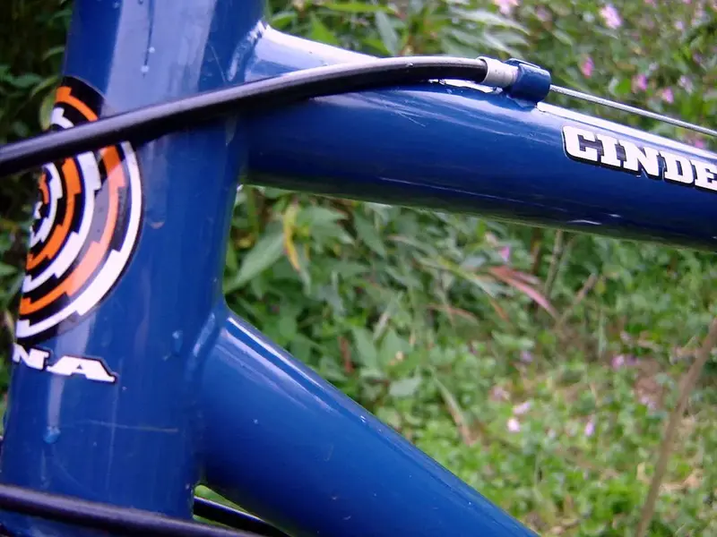

As to durability, time will tell. I've been riding the bike regularly for a few weeks and haven't had a chip or scratch yet though.

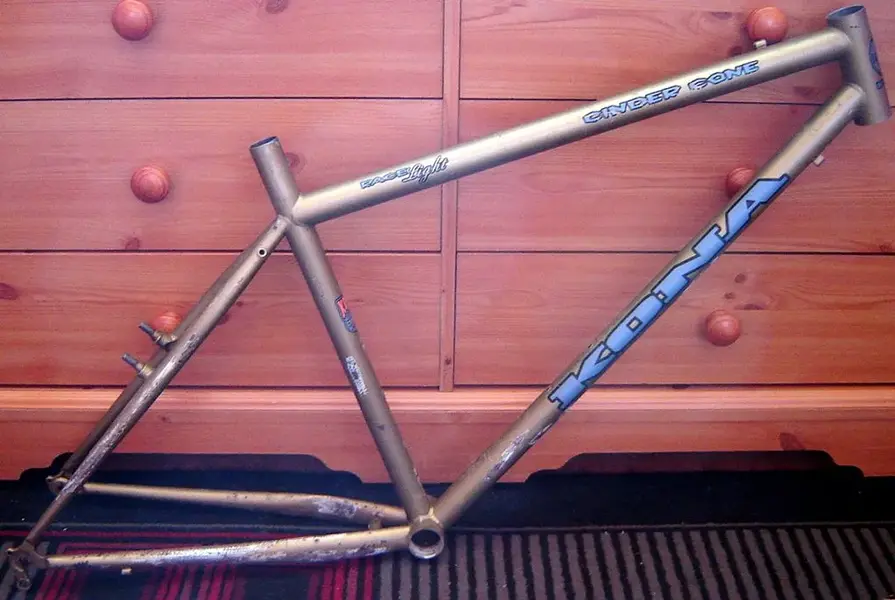

Aye, I could see that the original gold paint would have been nice when new , but it was too far gone really. Even "Cillit Bang!" wouldn't have saved it.

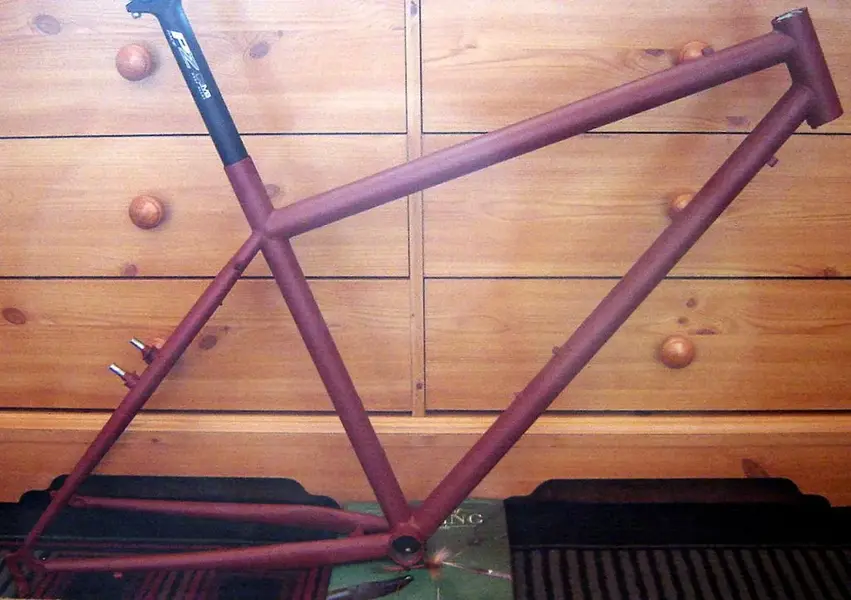

I used a brush on Red Oxide primer this time, because the frame had previously suffered surface rust damge and minor pitting. I wanted to ensure that the frame would be protected from now on, so I applied three good coats.
