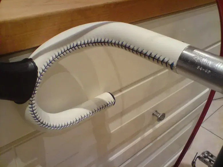

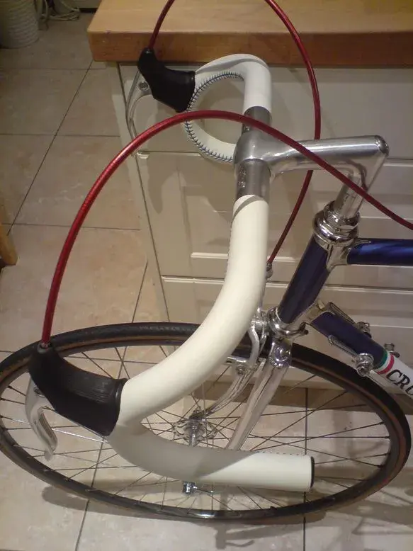

I've finally got my bars done :) Not sure I'll be in a big rush to do it again!
You've listed some brilliant tips that do make it much easier, soaking the leather is probably the most important. The leather I bought became as pliable as plasticine once it was wet, so you can bend it, tighten it and it dries even tighter. Starting off is the worst bit, I've used Cinelli bars so needed to get it square to the step in the aluminium. Not easy, as you try and stitch and pull tight at the same time. I had one big cock up on the second side. When I cut the leather it must have moved as I cut it so the two long sides weren't parallel. I didn't realise until I was half way along the stitching and couldn't pull the two sides together :cry: I had to strip it all off and start again with a new piece of leather. Also my thread was a bit thin, I'd say you need 1mm diameter at least.
Anyway, I'm quite pleased with the result, its takes forever to do but its cheaper than cheap bar tape :) Its cost me about £3.50. There's a massive range of lamb, pig, cow and calf leather on Ebay in lots of colours. Even saw some snakeskin and stingray skins....................now that would be interesting :D

Astonishingly good work both of you! It is odd you know, I can tie a size 18 fishing fly so that if you saw it on your arm you would brush it off. I just seem to have a blind spot when it comes to handlebar wrapping. Are you now going to treat it with something to keep the dirt and elements off?

Thanks :)

Btw where did you get the transparent cable outers for your Crowther?

The cables were already fitted when I bought my Crowther but I've seen similar cables on Ebay. It not always easy to tell from the photo's but It looks like Campagnolo do a transparent red cable set, if you're feeling flush :D
