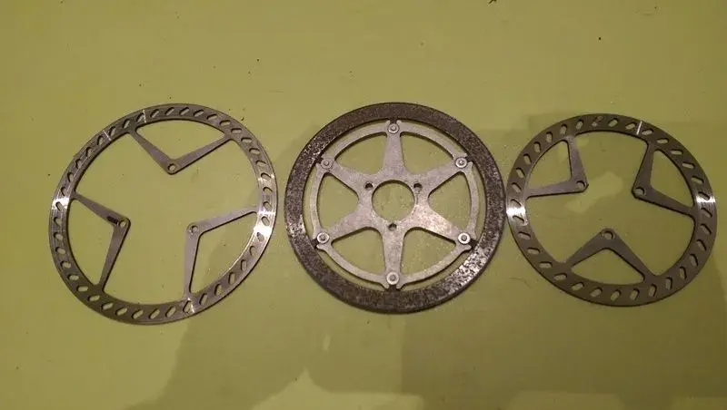

Here are the 3 rotors that B3 referred to:
Front AMP/RockShox, Front AMP floating, Rear AMP/RockShox.
From my measurements:
Front: 163.5mm diameter, 2.2mm thick, 12.9mm wide brake track. 3x 5.2mm holes on 60.4mm (2.5") bolt circle.
Front floating: 152.5mm diameter, 2.2 thick, 13mm wide brake track, 3 x 5.2mm holes on 39mm circle, 30mm centre hole
Rear: 134mm diameter, 2.2 thick, 12.9mm wide brake track, 3 x 5.2mm holes on 44.5 circle.

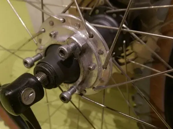

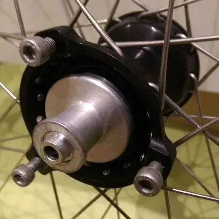

Hub fittings in same order:
Later front:
Floating front:
Later rear with bolt on adapter:
I can lend them out or make some proper drawings if you need, STL or dxf etc.

The 2 front rotors.
Ooh..that'll be a 145mm front rotor with the slotted fittings :D ....things are getting complicated :roll:
