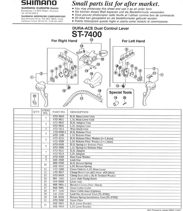

I've got a couple pairs but none in very good condition (working fine but with some scratches and chrome faults) so I was thinking to disasssembly and polish ... but looking at the diagram it seems specific tools are needed... Anyone has any experience with these levers ? Any advice ?
its a bit fiddly, but not really that hard to disassemble the levers.
i would start out with detaching the lever from the main body, then moving on to removing the front cap and main brake lever.
if they work fine, i would just flush out the old grease and debris by bathing the entire assembly in degreaser.
if you need to dissasemble further, due to a loose spring or something - it's possible to remove the castle nut by using some thin needle nose pliers, unless you have the capacity to grind a custom tool.

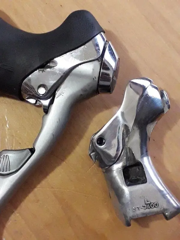

Here a pic after removing the lever , sanding the chrome and polish.

just pop off the logo-button in front and unscrew the bolt holding the front piece in place and pull it off.
there is a spring in there so be ready for it.
after removing the front plate, you move the small lever over to the side and unscrew the single screw holding the main lever to the gearchange asembly.

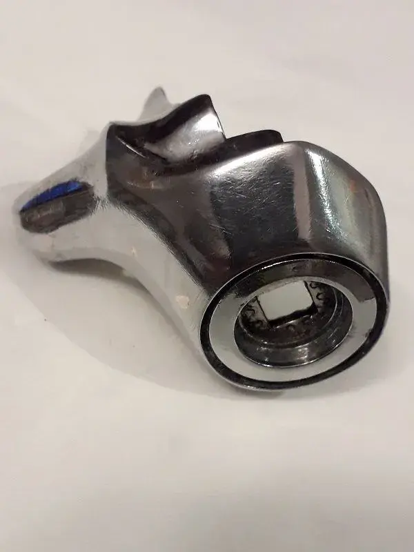

Here it is the result, the front cap polished...

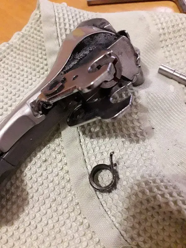

No way. I read now there is a special tool to assembly the return spring..... The pics are for 7800 series, but should be the same . Tried with a cable brake end but didn't work.
