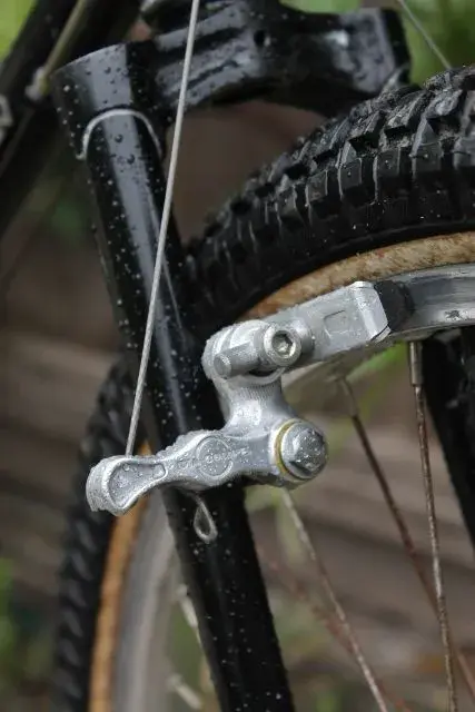

I originally intended to fit a Suntour Superbe Tech rear derailleur, but reading reviews of them put me off, so I went with another period one I already had. I decided against going full original, but would definitely have kept all that if it had come with the bike. The Suntour XC II beartraps go for way too much money for me to justify getting them for my bike. Last I checked they seemed to be going for 3-4 times what you paid for the whole bike!

Hey, thanks for posting. Mine came with the Superbe Tech mechs. They are things of beauty, but as you said they have a terrible reputation for reliability. I don't intend to ride this bike hard so I'm hoping I get a lot of life out of mine. I do have the beartraps and they seem to be in decent shape. One of the things on my to do list is to repack/replace the bearings and give them a good cleaning and polishing.

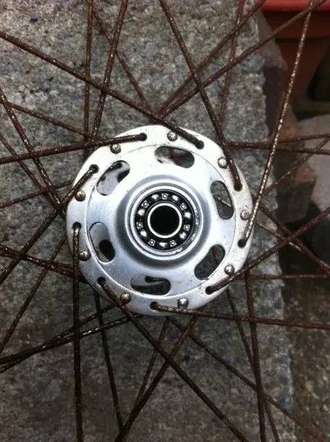

My only issue is the rusty spokes. I really would like to re-lace the wheels with modern stainless steel spokes, but don't know if that's in the budget.
Hey there. So I've been slowly picking away at this bike over the months. Now that my Bianchi Rekord is pretty much sorted I'm focusing more on this bike. I've stripped it down, cleaned the frame with a combination of soap and water and carnuba car wax. I'm now touching up the paint with testors gloss black. I will probably give the whole thing a clear coat when I'm done that job. I've cleaned and repacked the headset (bearings in excellent condition - annodizing on outside not so much). I've soaked the rusty bits in a rust removal solution and gave them a quick polish after. I"m pretty happy with the results (see crappy phone pic below). I also decided to repack the hub bearings. Well, I was pretty blown away to find that the sealed hubs had actual sealed bearing units in them. I pulled the covers to repack them expecting them to be full of dirty gummy grease. Well it was a tad gummy, but it was completely clean. I've cleaned the front one with solvent and a toothbrush and will repack and reassemble when dry. You can see from that image how ugly the spokes are. I've experimented with aluminum foil on a couple and it cleans them up alright. No crome left to speak of, but I'm not replacing them yet. I'll just tidy them up (maybe paint them - don't yell at me) and get the bike ride-able again.

Great bike, and a great deal! I have the same bike, and it had spokes as bad as yours. I ended up relacing the wheels with new SS spokes and nipples. It wasn't too bad, about $80 for the parts, and pretty easy to do. I was also able to really clean and polish the hubs and rims when everything was apart. The wheels are the nicest part of my bike now.

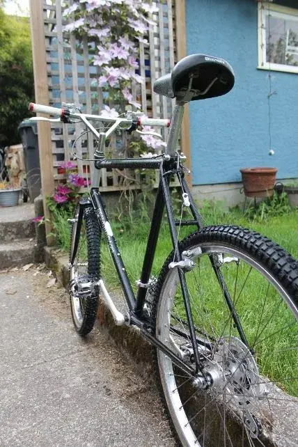

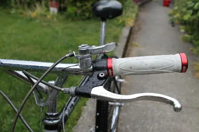

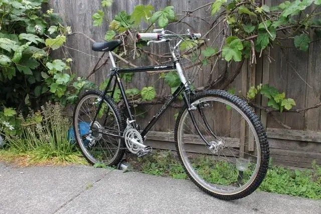

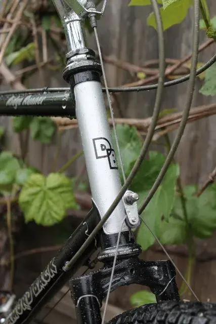

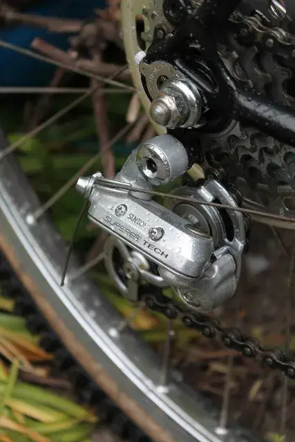

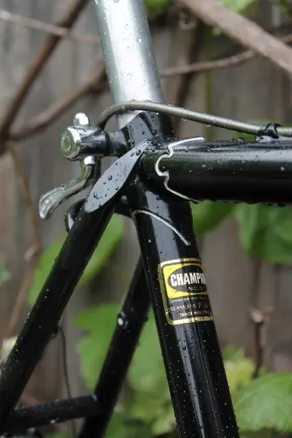

So I finally resized the images.
So a few more images. Sadly the bike is too small for me and I need to make room in the garage so its going on the market. :cry:
