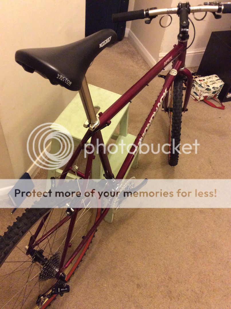

so i finally got round to putting it all together last night - but got stopped 60% of te waydue to essential TV watching.

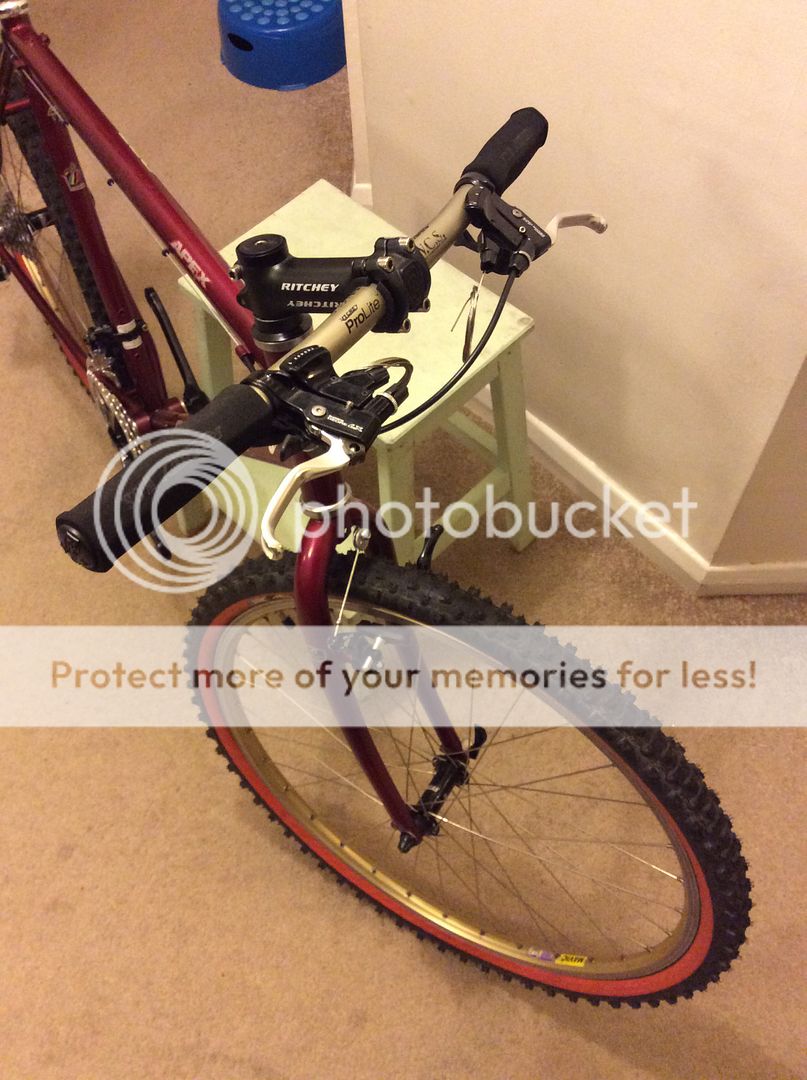

but here's whats materialised so far....(one more purchse that will see a front canti cable hanger installed in the steerer stack)
pics are a bit naff - will get higher res ones once i've finished though.
Headset feels rough, so may change this out for a new one but it'll do for now.

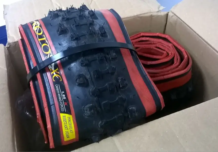

and im STILL not sure i've scratched my perfect tyre itch for this one - despite shelling out a fair amount for the IRCs..... :roll:
Surprised no ones pointed out my rear brake cable route was incorrect....
Fixed now. Just waiting for the front cable hanger :)
Rear mech was a bit perplexing to setup, but I was prepared for this as the hanger has been repaired, so its not perfectly aligned. But I think I've indexed I all fine now.

Cable hanger and some fresh brake outer received yesterday will see me finish this next week.

Great work so far! Those tyres would look good on my red Brodie (what kind are they?).

nice bike and work so far. I have to protest against that stem! Get something that is not wider than down tube :)
Lol, that's a fair point! I would have got a stem with canti hanger, but they don't seem to exist in threadless 1 1/8th flavour...
Its a parts bin special but will do for now;)
