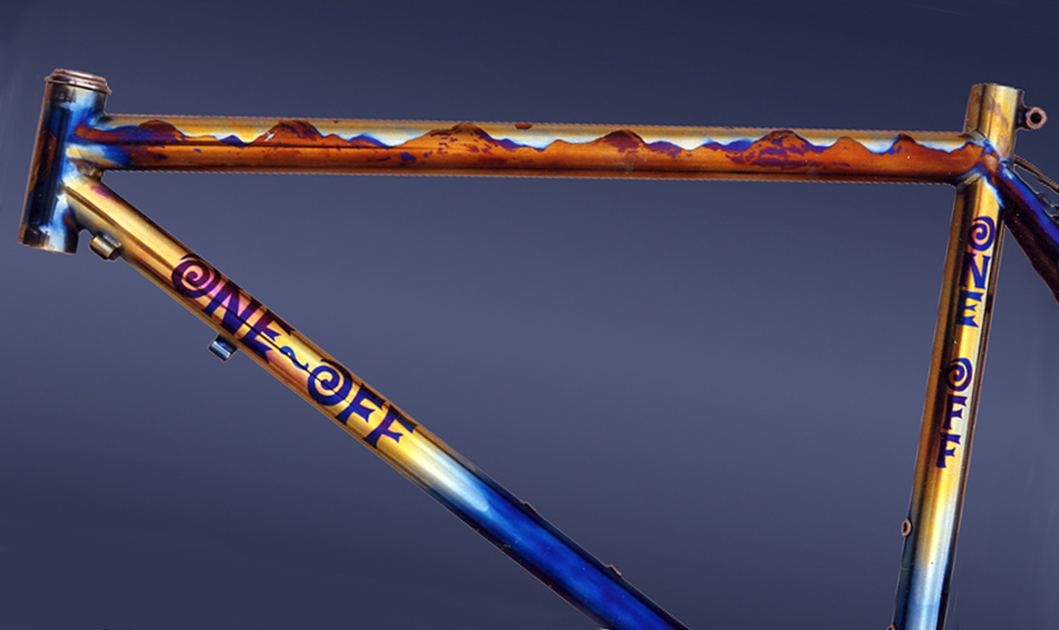

You can anodize Ti as well. Different voltages=different colours. Leni Fried is a master at it (ya might not want to look at the price list).
http://www.titaniumarts.com/anodized.html
