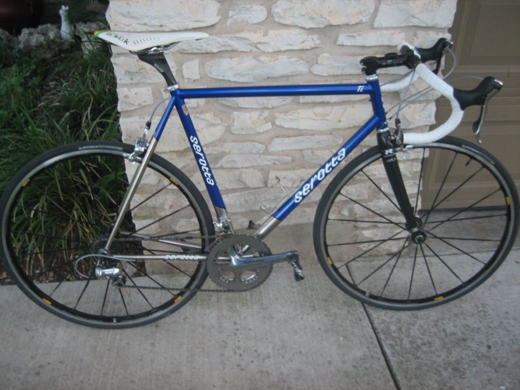

Tell me these would look better in plain grey:
http://www.dekerf.com/specials_ProdigyTi.asp
Viper blue and ti is particularly sweet!

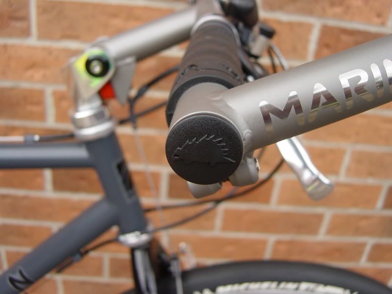

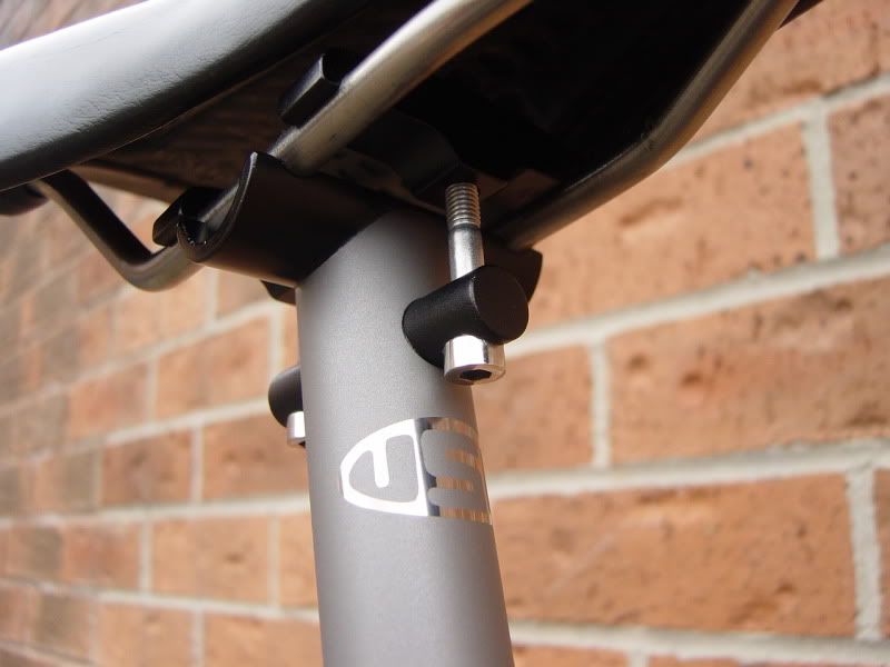

Seriously though, I think that showing some ti through the paint can look really good, I'd try to ensure I'd leave some showing. My favourite ti finish though has to be the x-lite (Raleigh special products) frame that was matt finish, but with polished ti 'decals'. Looks very classy and I think enigma do/did that to their frames.
That's the stuff, looks amazing in my view. How did you do that (not wanting to hijack this thread)
Thank you :D
Page 10 of my Marin build ;-)
Cheers,
WD :D
I've seen your Marin before, but still every time I see it I'm very impressed!
How was it blasted? Bead blasted or something courser?
