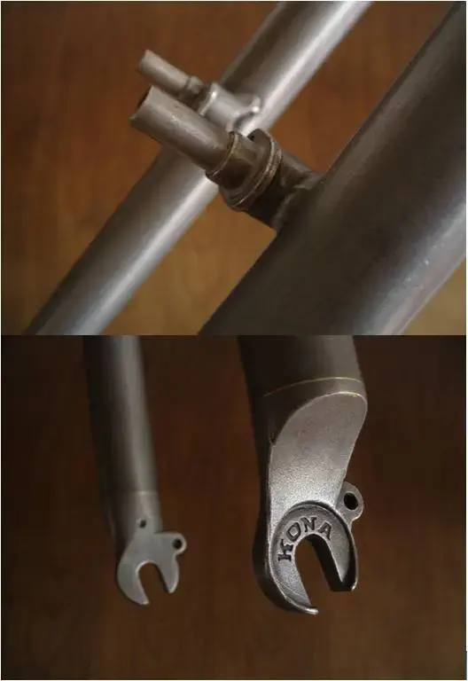

The dropouts seem to be a good way of telling, the triple butted variety have a forged dropout which is more swooping in its shape. The single butted (PG) forks have a slightly more crude welded on dropout.. the picture below is triple butted..
